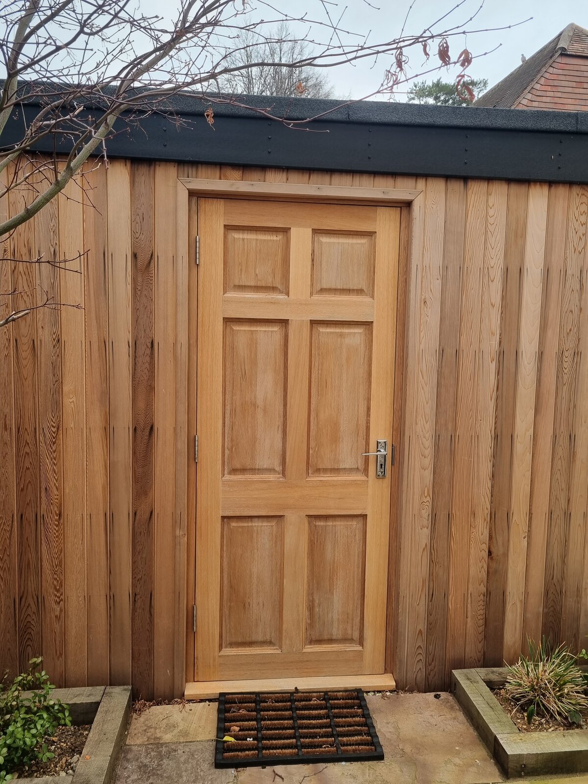

Door swelling and sticking
If it's the bottom of the door, you could try the old rough sandpaper on the cill trick and opening and closing the door a few times. Then wax the area that's binding.

Well sandpaper didn't do much so I bought a 10 quid stanley planer which has got rid of the sticking points all around except the bottom of the door where there's no room to plane. Reluctant to take the door off yet to plane. Clearly, can see the middle part of the door is lower as there's wetness there in the mornings. Not sure where the wet is coming from though as there's no wet around the door or on the step in the front of the door. Could it just be condensation forming over night?
Given that you don't want to take the door off, you could sand/plane the door sill.

It may be the case that the underside of the door is not sealed.
I am a decorator, but unless a customer wants to pay me to remove the door to paint the underside, I will "nudge" the brush as much as I can.

What's with the resistance to taking the door off? It takes minutes (even seconds) - get your knocky-knock out (impact driver) and whip those screws out it's a newish door so should be easy. Do the necessary. Replace highest screw in highest hinge loosely by just tipping the door so it lines up. Swing the door out at the bottom so the bottom screw can be replaced. Insert and tighten the rest - job done.
Original screws, in original screw holes will reinstate the door in exactly the same position. Why wouldn't you?
Mrrusty you haven't seen my DIY skills! I used my cheap wickes planner enough to make the door as 'sticky' as I could bear and the dry weather has helped even more recently so it's shutting and closing better now albeit a bit stiff. Dreading the summer I might have a gap!
Have you put a weatherproof varnish on the door?
It looks bare to me.
It's funny you should say that as I was just thinking I really should treat it based upon previous comments above and now the weather is getting better. Do I need a stain or a preserver? How much in quantity? Oh lord, I guess I will need to take the door off after all then to stain it.
In a perfect world the door would be treated before hanging but it all depends on the finish you want to see at the end: a natural look wouldn't need a stain, and clear gloss/matt varnish would maintain the natural appearance of the door.
I usually use Ronseal: it always does exactly what it says on the tin.
Until then, don't take any more off your door, allow it to dry out and around the equinox you should be able to enjoy a day in the spring air to do the job.
I just need it matching the the shed. I dont think the shed wood will fade anymore.
