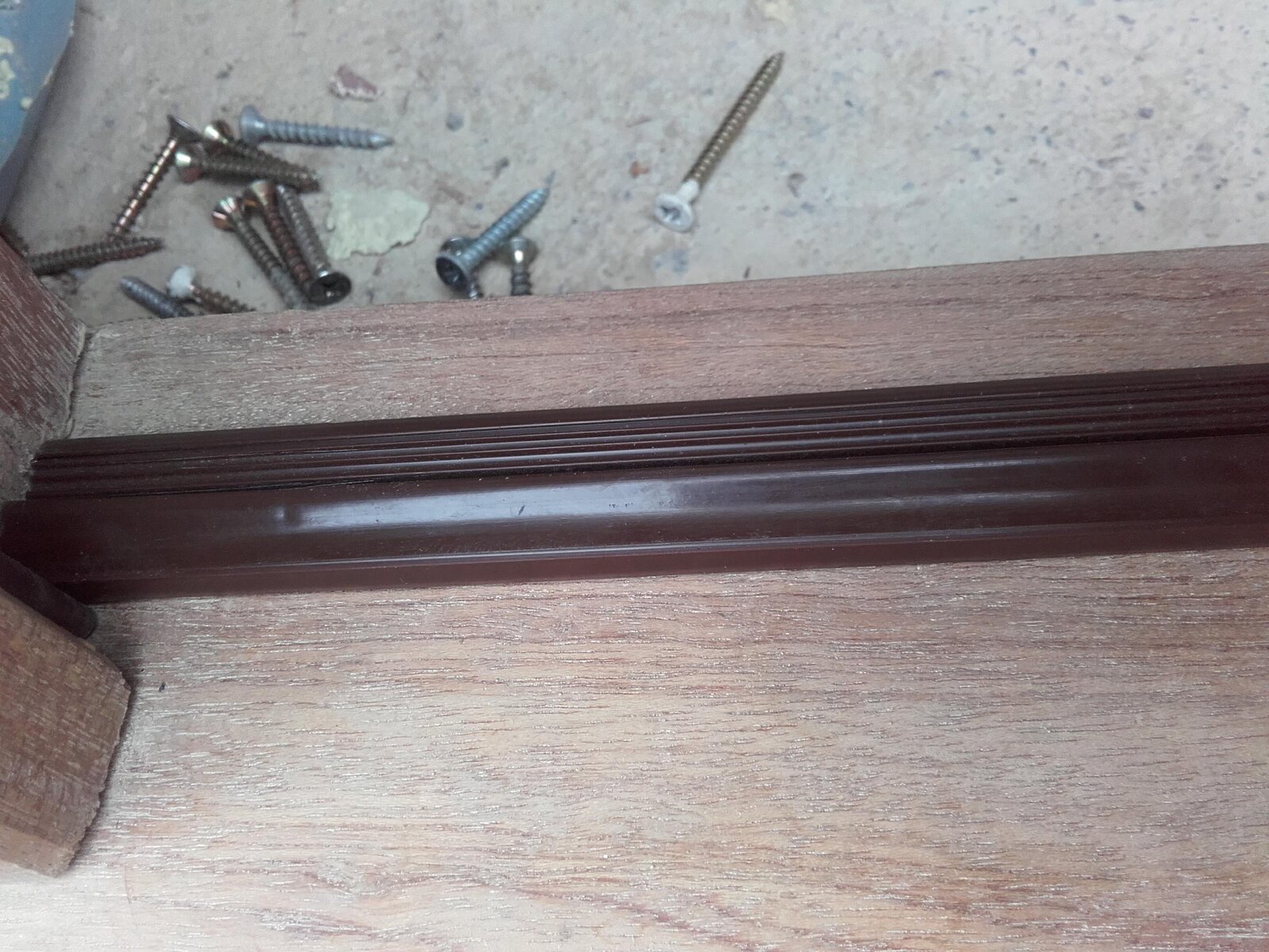

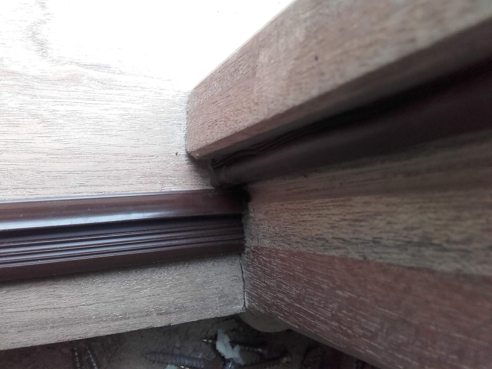

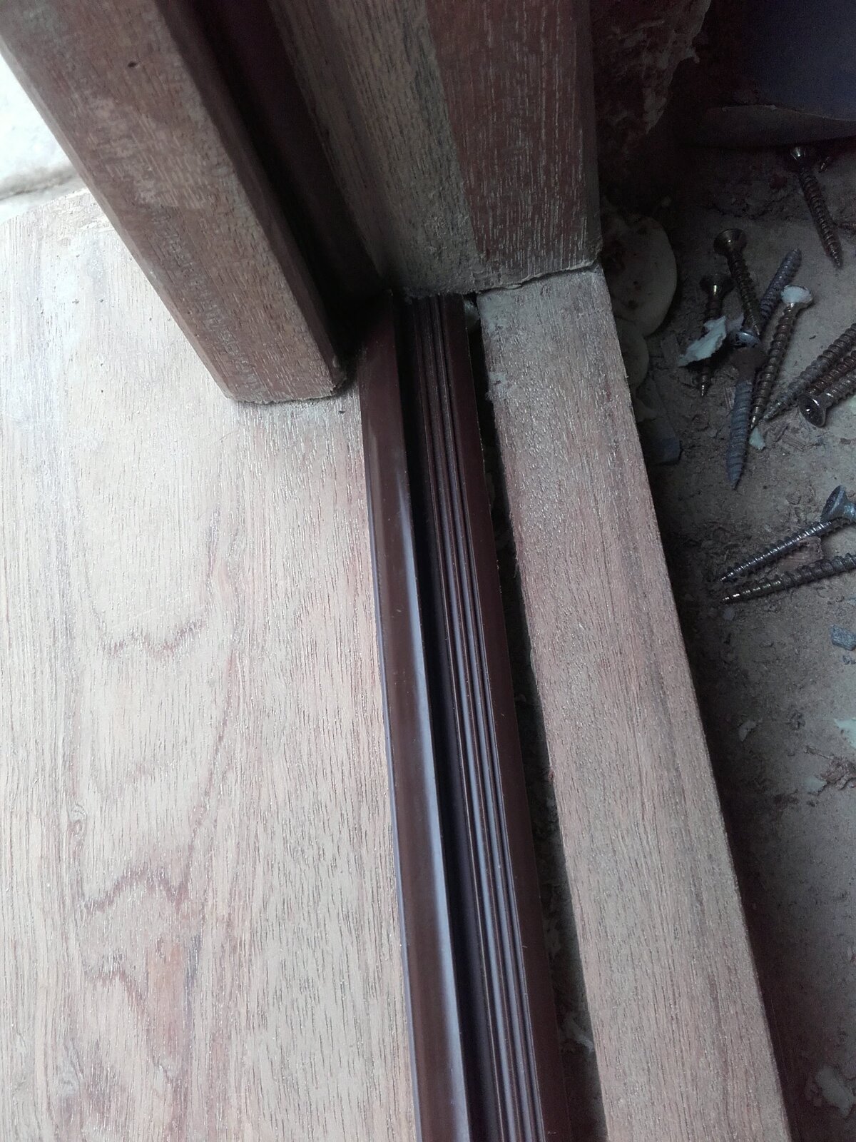

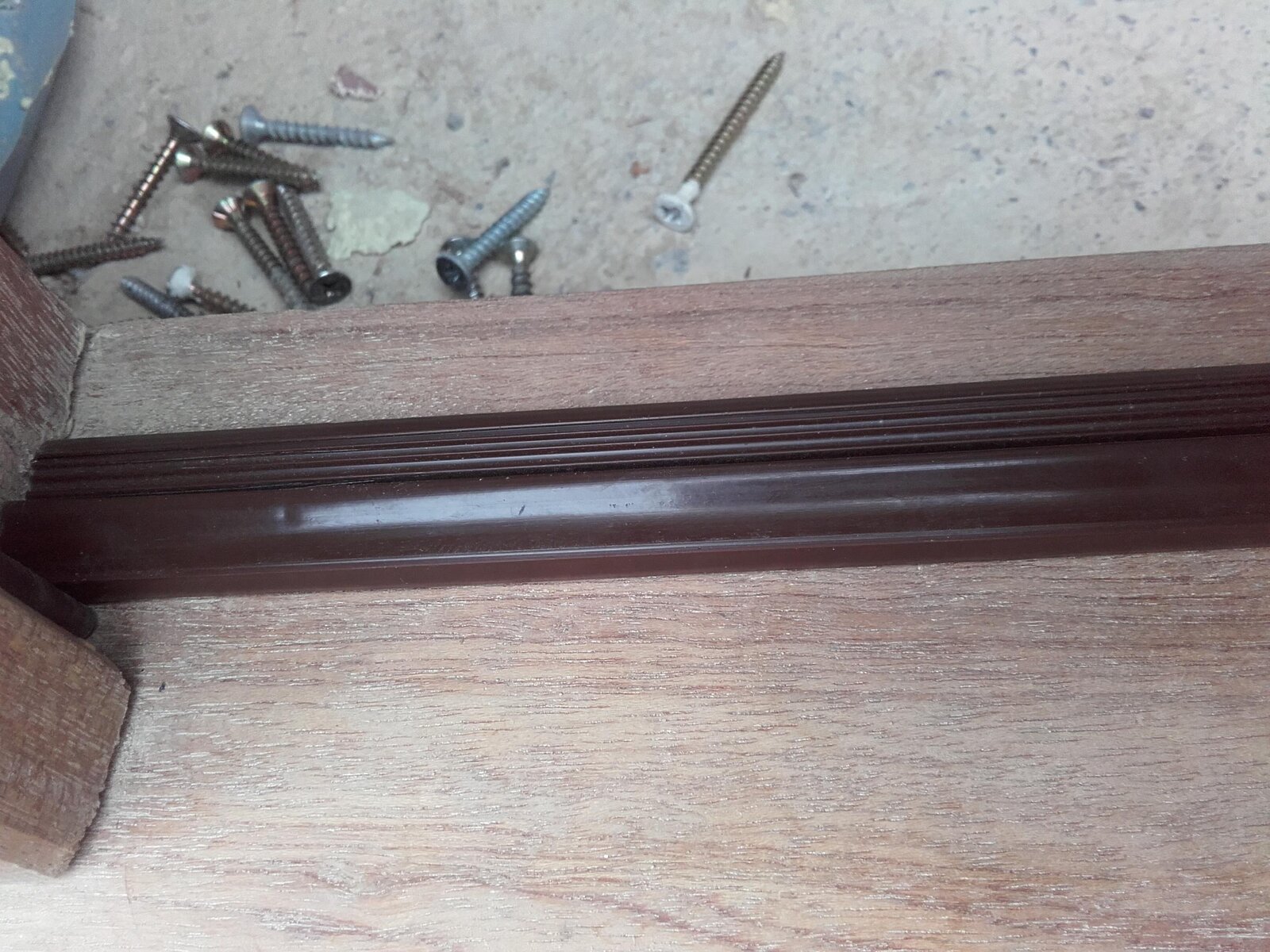

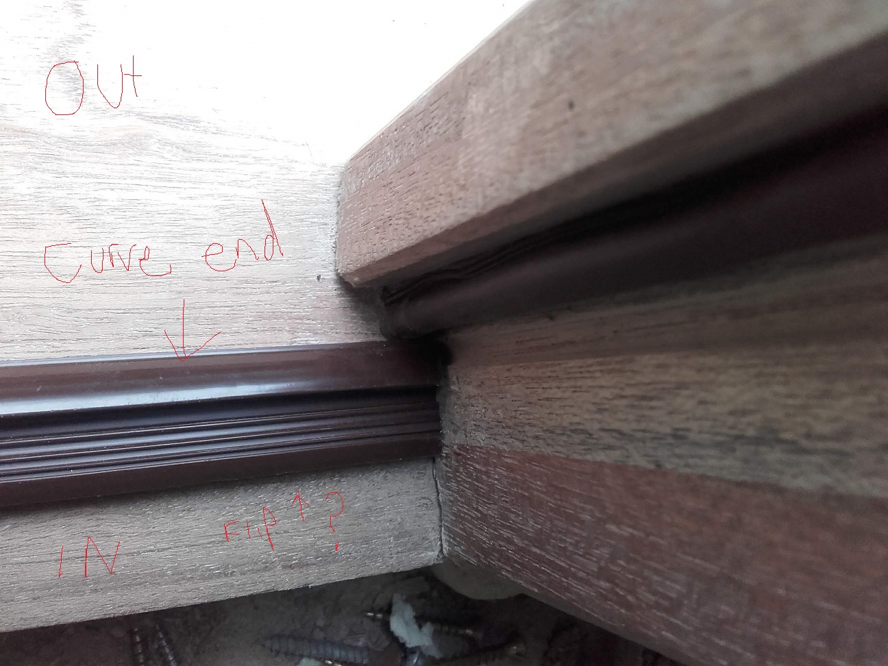

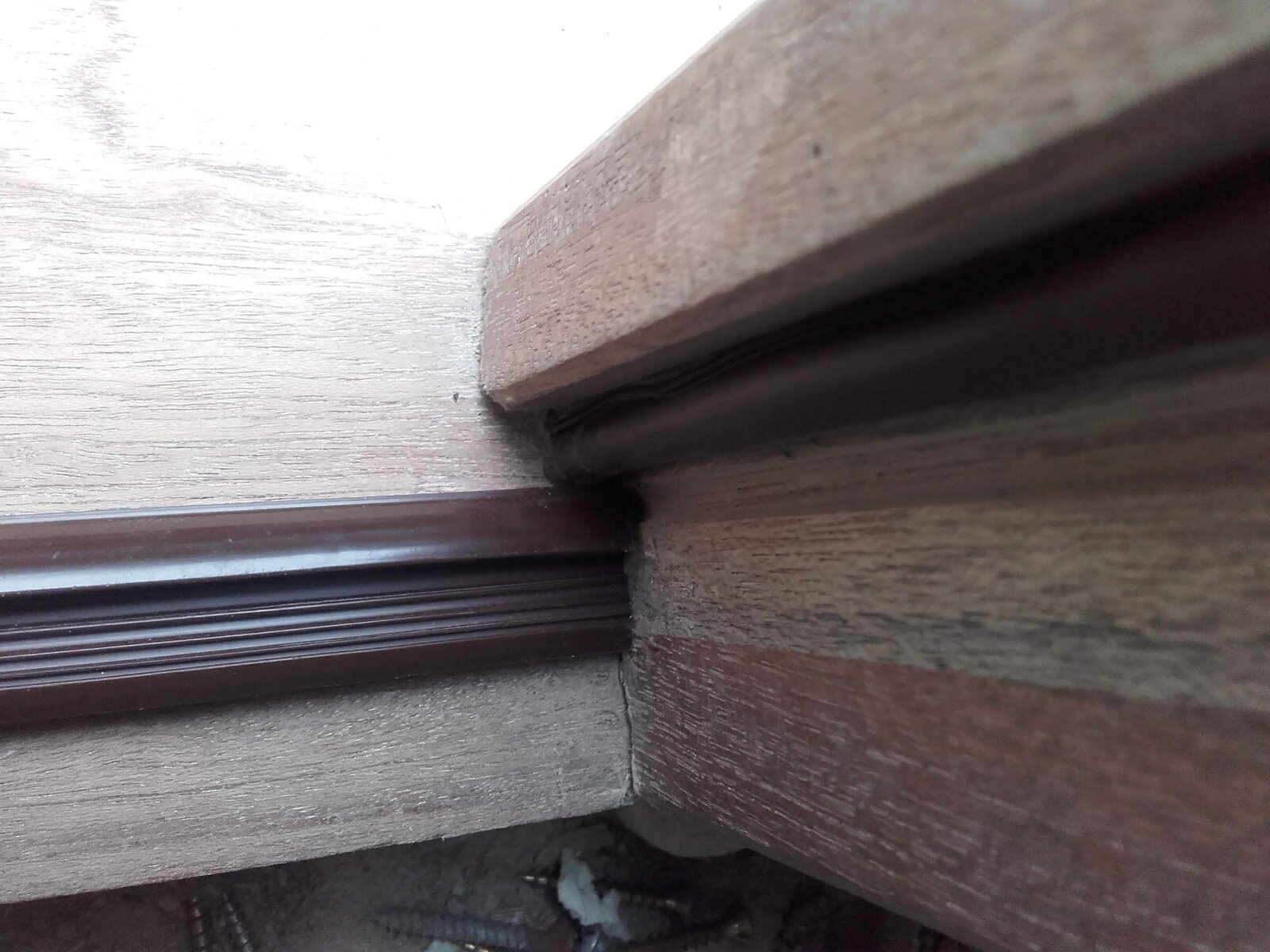

View attachment 204969 No the curved side faces inward, that side is the side with the draught excluder, the rebate you are going to make with your router presses against the curved side and creates a seal
so, I am currently wrong way around lol, so curve to inside, here on these pics I need to turn around yea? door opens inwards not out.

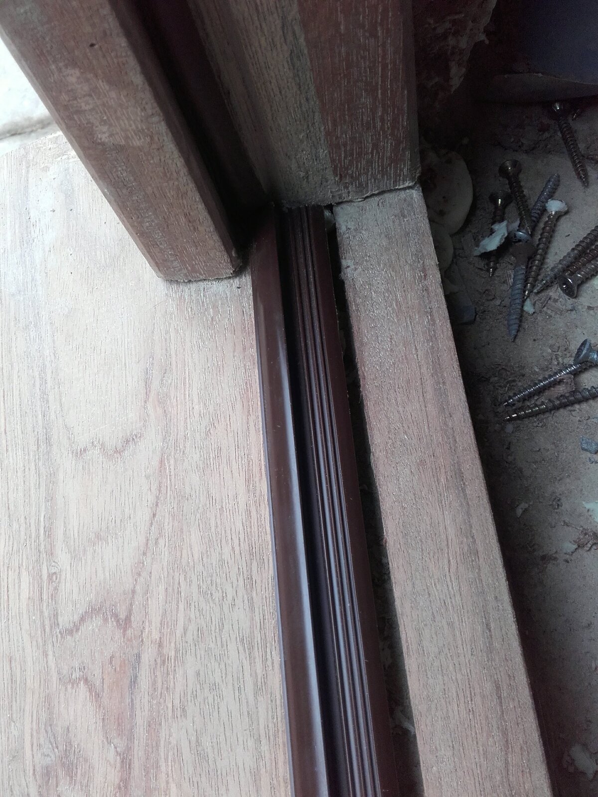

Mate your pictures don't show a great deal, take a photo of the end of the strip so I can see a cross section.
I worked out the door opened in from the photos of the frame, the door has to shut against the rubber so it's no good the rubber facing out is it, needs to face in so the door touches it

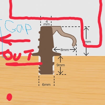

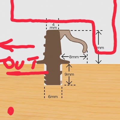

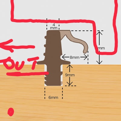

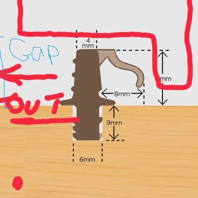

Hmm try this one here you can see the rubber curve facing outside, I think I just need to turn it around to face the inside now. When door closes the rubber will hit under middle somewhere but there will be a gap cosmetic wise looking at the door outside at the bottom where the ridge is, I assume I need to cover that with a weather shield.
And yea it will be like this where the gap at front will look like its not touching bottom, so assume here I just add a weather guard to cover the void gap?

The gap is hidden from view with the weather bar but that in itself still has to be high enough to clear the weather strip otherwise it hit the weather strip when opening the door
Just as an example using this picture the weatherstrip would be fitted here with the rubber bump/flap facing left

Hey man thanks no I got it now its sunk in I could not fathom why I would leave a gap from the sill to bottom of door but now I know its because you need to insulate it right, I can do this and thanks again for all you help :)
