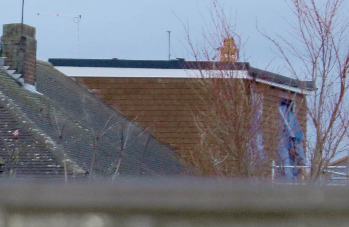

hi all,
I've attached an image of our dormer loft conversion under construction.
The lip of the dormer roof is higher than the ridge tiles. I'm presuming this will be trimmed down, although they have torched the felt on now so I wonder if its too late?
Any advice from somebody who knows about dormer construction would be very much appreciated.
thanks in advance

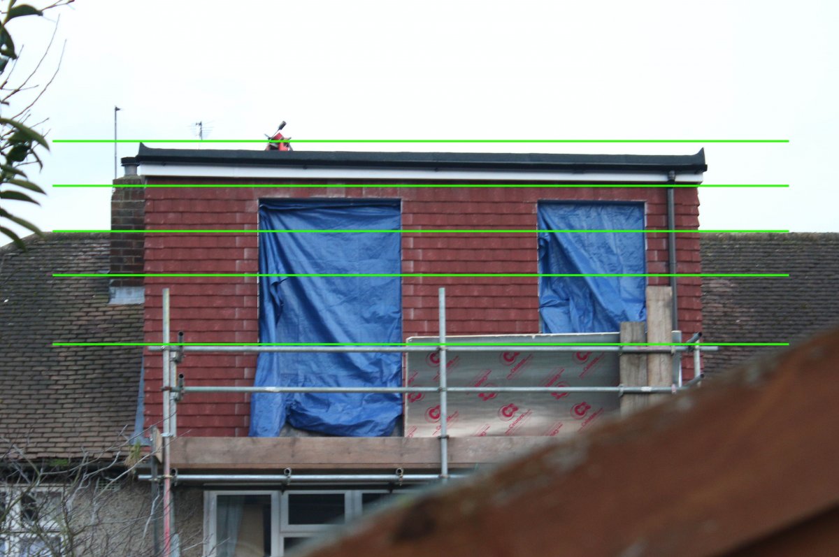

has this been done under permitted development as technically it would be in breach, but enforcement would be unlikely for such a small amount. However I would wonder why they have done this, what is the headheight in the loft room?
It's never too late to do anything but would mean completely re-building the roof, dormer cheeks etc

It is under permitted development. They have agreed to trim the lip that stops rain water blowing on to neighbours roof. Not sure if they will need to shave the firring as well but then we lose gradient on the flat roof. They say its no problem. There was no mention of taking the structure apart.
As long as nothing is higher than the top of ridge tile we are fine, I hope.

There was plenty of headroom in original loft, about 2.3 metres I think. The builders say the neighbours ridge on the right is 3.5cm higher than the neighbour on the left. Our new ridge tiles will be slightly higher than our old ones but they say it will be millimetres and barely noticeable. I should get that confirmed in writing.

If your going to be putting ridges back on then I wouldn't worry about it, particularly if it is in line with the higher neighbours and to be honest if they aren't level then whos to know that yours weren't different too. Just let them crack on. That being said with so much head room to play with not sure why they didn't keep the line well below the ridge.
If you are going to put the ridge tiles back on then nothing too worry about !!!
Erm I think you will have to catch the BCO on a good day to get away with that nonsense, its a clear guideline not to go higher than your original roof line.
Am I right in thinking the 2.3 ceiling height in bedrooms doesn't apply now ? so the roof could have been dropped anyway.:notworthy:
There is no legal minimum headroom to loft conversions (save over the top of the stairs) so the beam supporting the ridge could have been lowered without undue
problems.
Technically, it breaches the permitted development restriction, but as the others have pointed out, it's only minimal. It is highly unlikely that the LPA would take enforcement proceedings because they have to go by certain guidelines; enforcement is regarded as inapproriate for a 'minor or technical breach where no harm has occurred'.

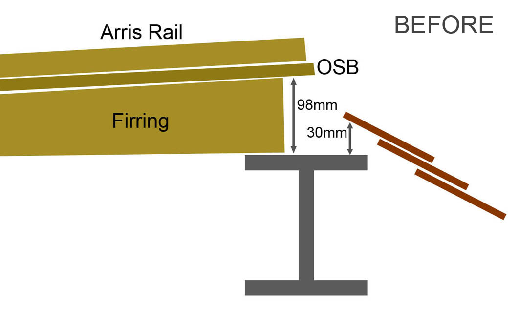

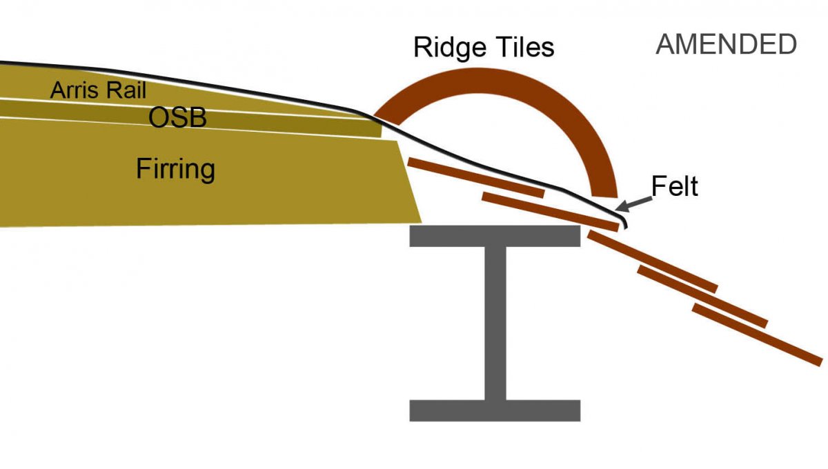

the builders amended dormer roof to keep below top of ridge tiles. they trimmed the firrings and will direct water under the ridge tiles and on to front roof. I've attached a couple of crude not to scale diagrams and a picture. I hope they can tidy it up a bit, doesn't look so neat now. The felt is 3 layers torched on. Never heard of this method before, I wondered if this is a good way of keeping a roof water tight?

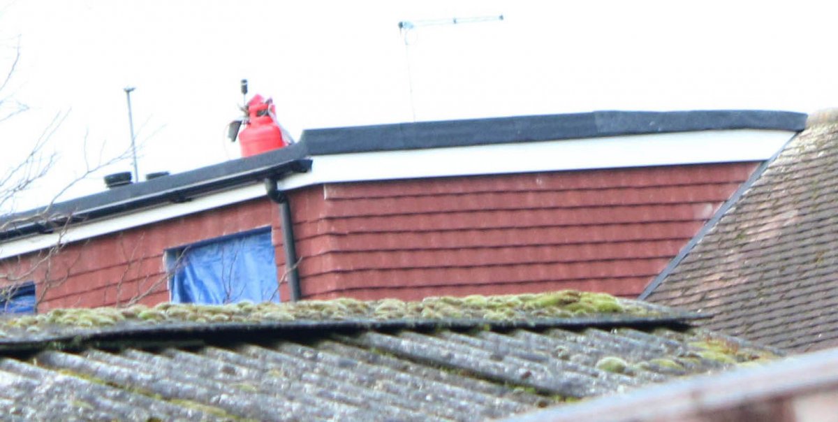

also, I hadn't noticed but the dormer roof leans from left to right. The others around here don't. Are all the scrape marks on tiles just from cutting? I'm presuming this will look better once its been rained on a bit.
Box dormers are never gonna win any medals for architecture, but I would like it to look quite neat and tidy
View attachment 95075 View attachment 95074 View attachment 95076
I think that's a recipie for disaster.
Just looking at the 3rd pic, of the dormer cheek.
Don't want to pour cold water on it but I suggest it could have been done a little better. The capping on the fascia is not right; they seem to have missed a course of tiles at the top on the front, and the junction between the cheek and the existing roof looks suspect. Have they just mortared or mastic'd it up?
These things make one wonder what else might not be right. But it's the ridge tiles that are patently wrong and the main problem. Perhaps you should have left them as they were, even if they were a touch higher?
