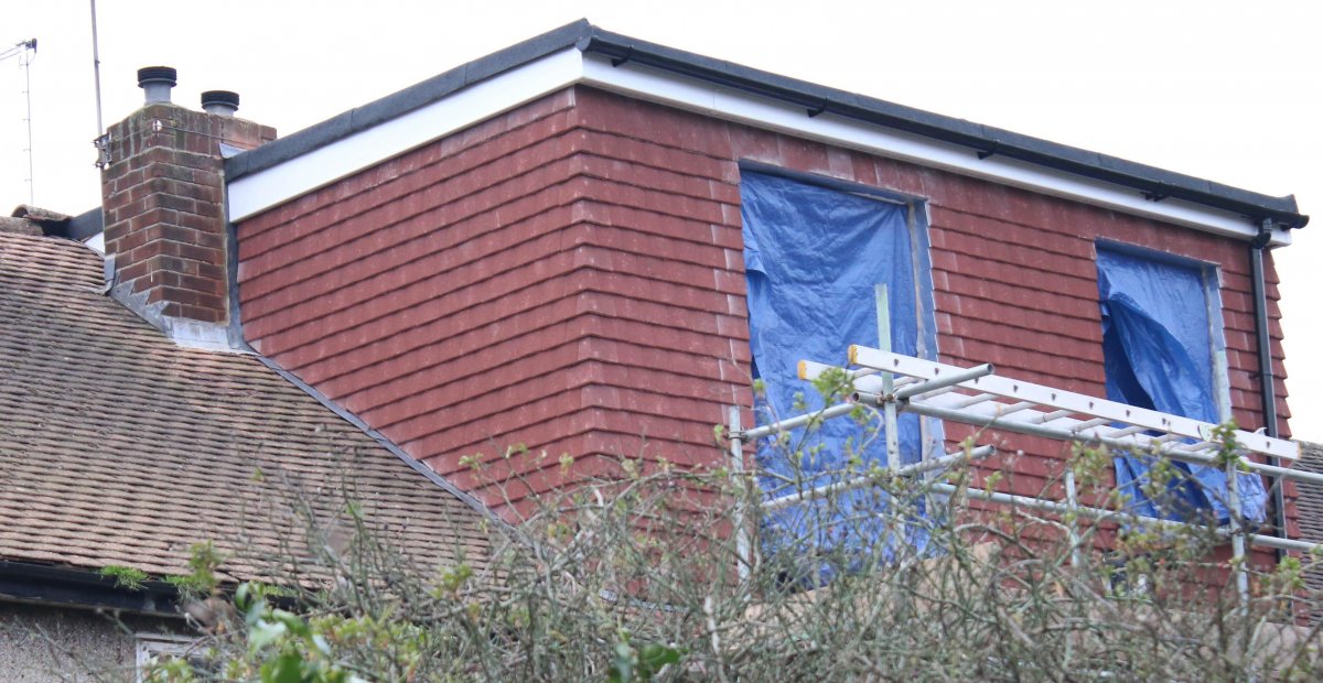

dormer higher than ridge tiles

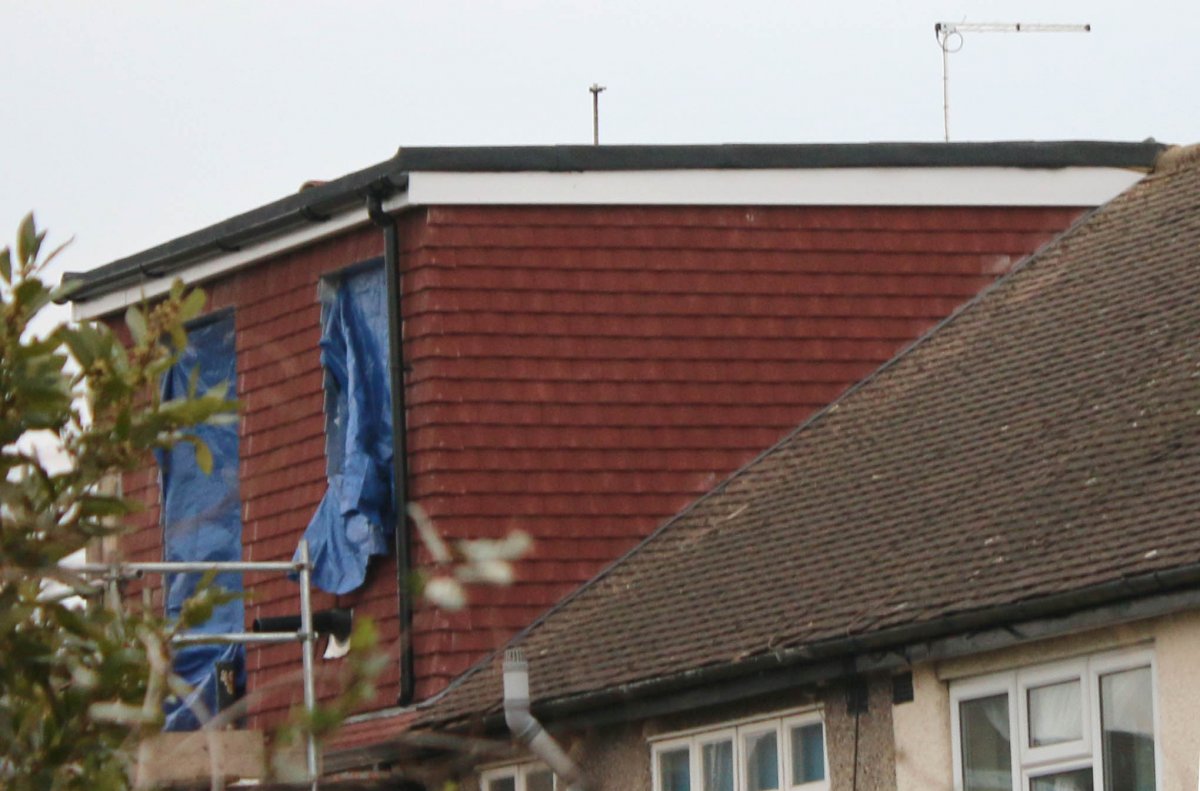

these are the best images i could get from the side datarebal.
the arris rails make it look like there is a gradient going in the right direction. Its only when you view from above you see the arris rails are deeper towards the ridge and the deck is sloping down towards the ridge.
