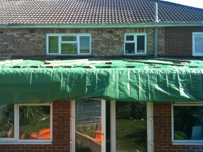

This is a picture posted on DIYnot some years ago,new tiled roof with 9 degree pitch leaked.
