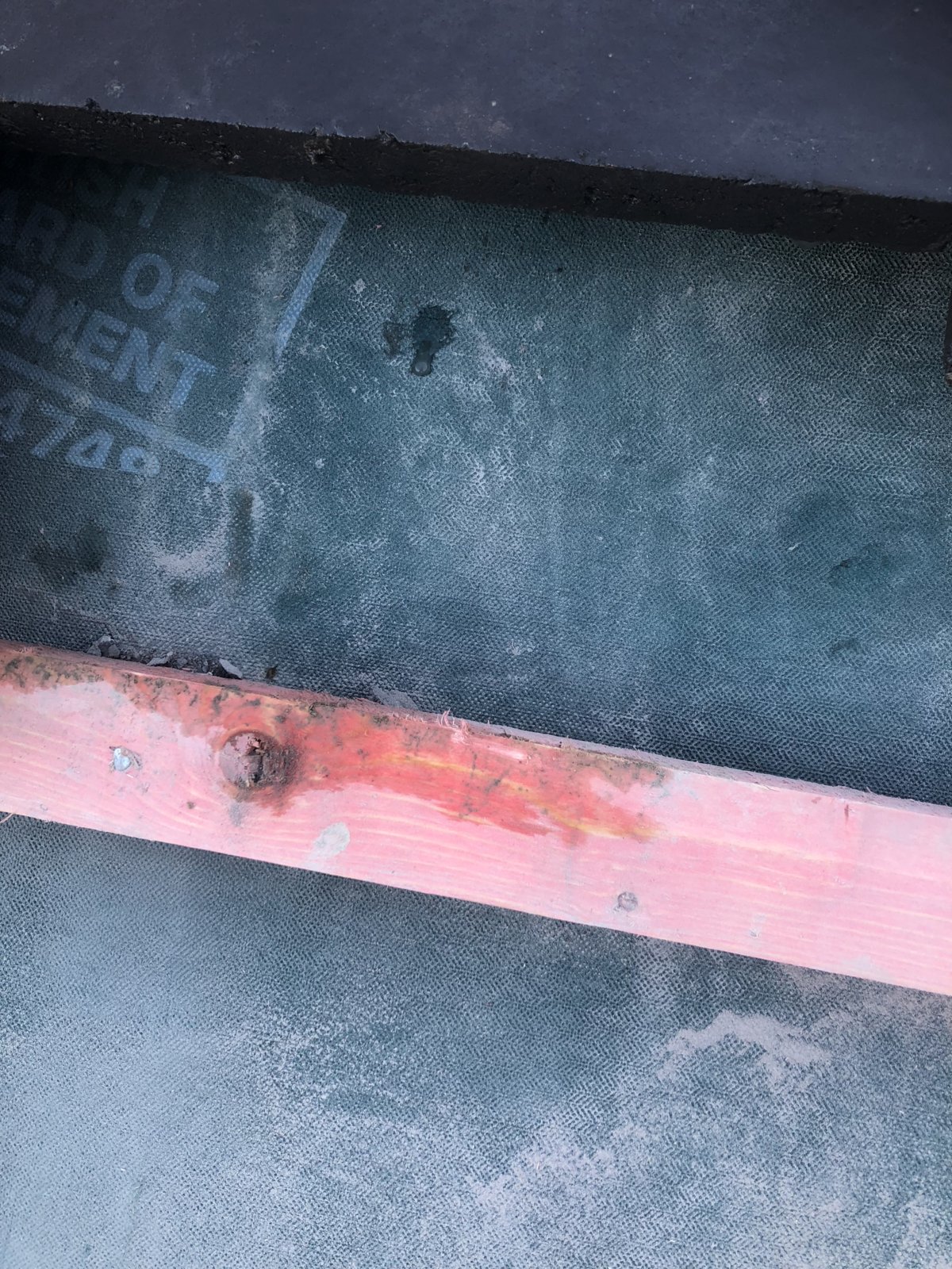

The batten above looks ok?

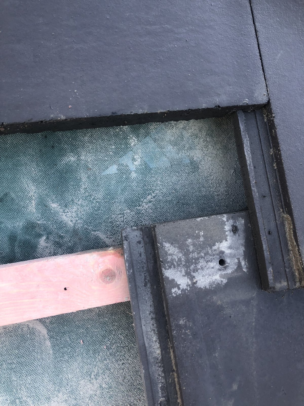

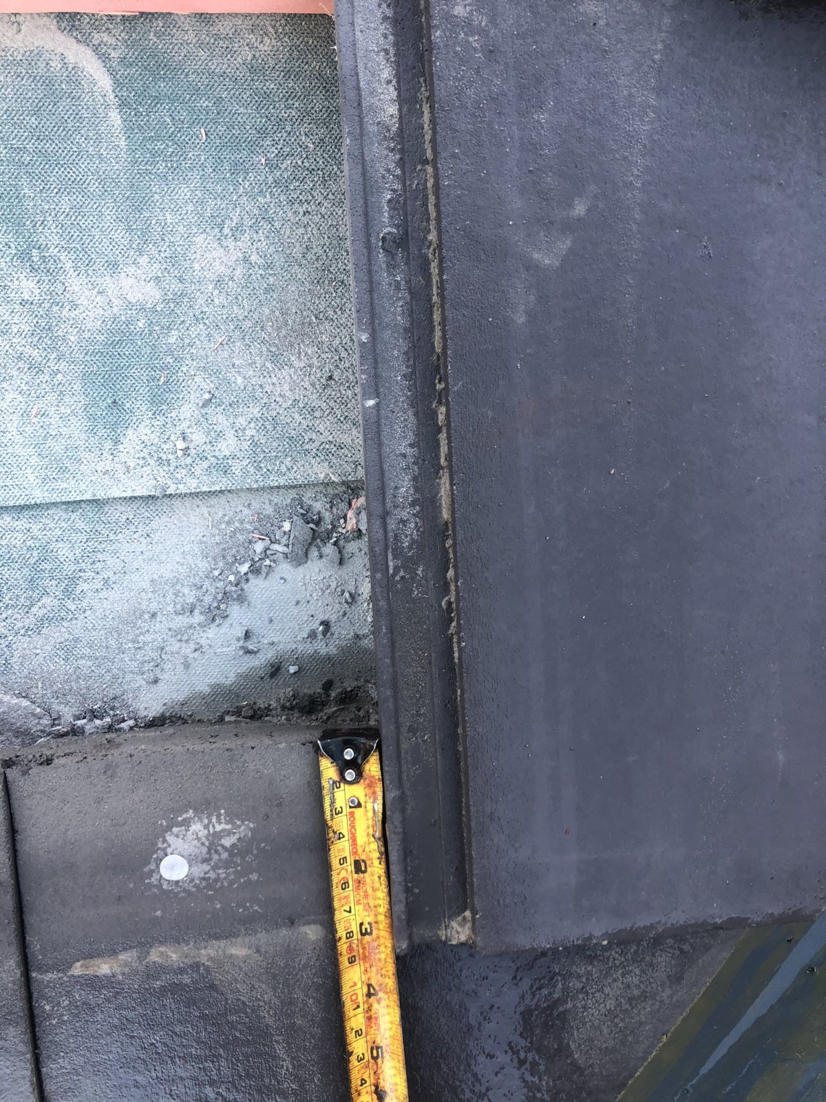

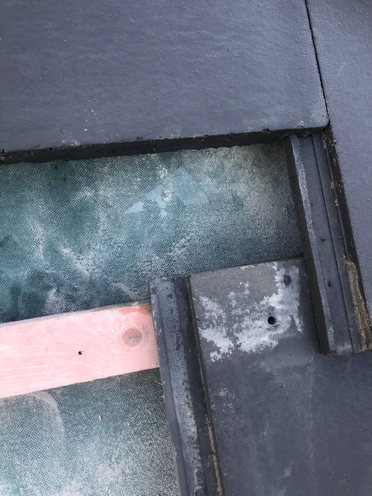

It is m8. I can’t work the picture out myself as it looks uncut but the valleys been cut and mucked. The reason I’ve noticed the ingress is due to the roof having 40 vents in it and couldn’t have any water getting in as the rooms were boarded when it was got in the dry. More pictures that are also alarming. Tiles Calderdale edge.
well obviously the top tile alongside the tape has been placed to show headlap.
picture ending 205 looks a bit less headlap ?

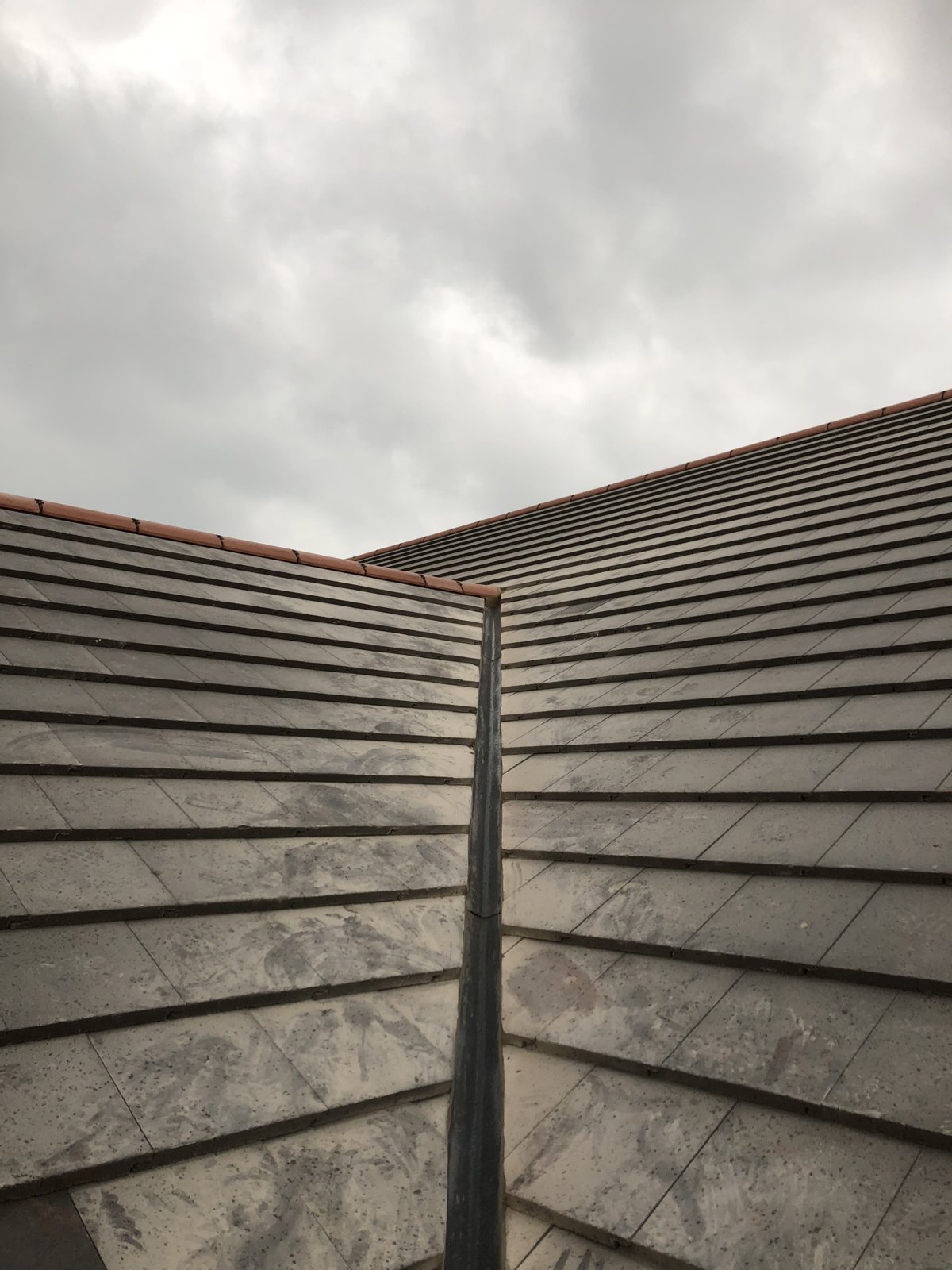

A shot of the whole valley might be good.
How long has it been completed?
It was me that done the roof m8. The pictures are more to show the unreliability of sandtoft Calderdale edge. We re having a rep out to cast an eye over it .
tbh there's not much difference between these and moderns or even mini stonewolds they have been around a long time. so a strange issue.
I do not see the valley is a problem if the detailing and mortar is correct.
was the weather bad when you tiled it in?
The weathers always bad in Folkestone to be fair. Calderdale edge are relatively new as opposed to Calderdale. The edge only have one water check on the channels whereas mini stonewold and moderns have two. The tiles are only pulled to what the manufacturer allows if even. But you still wouldn’t expect water to get over that check . Also when pulling the tiles out the backs of them were damp which could be down to being a green issue. Will need to wait and see what the rep has to say
We have to match what’s on the existing Premier inn Catlad unfortunately, and it’s open valleys on that.
It looks long and narrow that valley is it not possible that
when its raining hard its shooting across the valley?
I thought that was part of the reason for the closed
valleys with the ridge in the middle.
