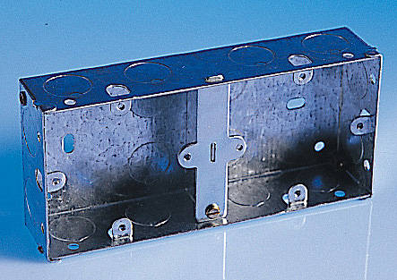

But as SS said, you'll need to dig a bigger hole in the wall, as it's a single gang dimmer, so you'll need one of these:

The box ban shows has fixed lugs so you have to be careful about positioning (not having a go, ban, honest!!). You could use 2 single gang boxes linked with a box jointing piece, Appleby make them not sure what part number. This will give youadjustment for out of true.
In any case, make sure your boxes are deep enough to mount dimmers and have space for wiring. Further, many mfrs insist on a certain depth of box to allow heat to dissipate.
The trouble is that if the box does end up not quite horizontal, you can't adjust two single accessories independently to be horizontal because they won't line up....
True, Ban.
Maybe better with Bans boxy little number, then.
