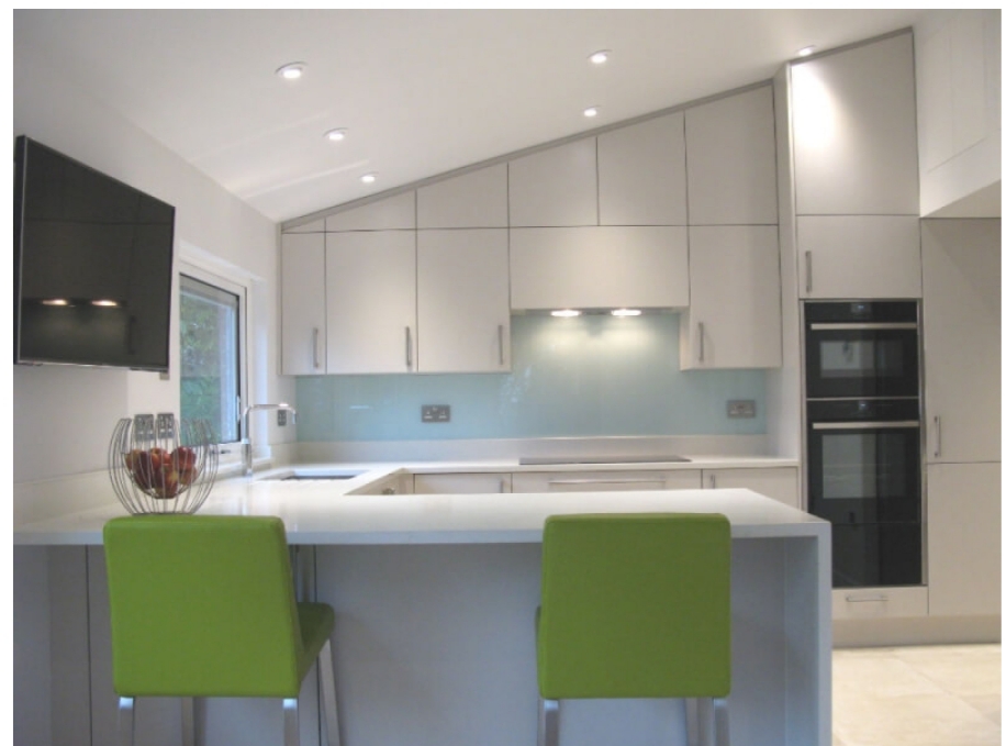

We are currently having a kitchen extension with a vaulted ceiling. I would like recessed downlights if at all possible but believe this is difficult with celotex insulation. Our builder simply said they will cut out a square of insulation around each light but my own research tells me this is unacceptable practice. Can anyone advise please on how this can be done?
downlights are fine just dont fit hanging lights like these!!
Cut out the insulation and you wreck the thermal characteristic of the roof construction. Building control will give you a very hard time as a result.
Best way is to have the Pitched roof constructed as a “warm roof”. This will give you a void under the insulation where the down lights can sit. Consult your architect and builder about this option.
There are also some very shallow recessed lights available that are little more than plasterboard depth.
Or (better) use surface lights!

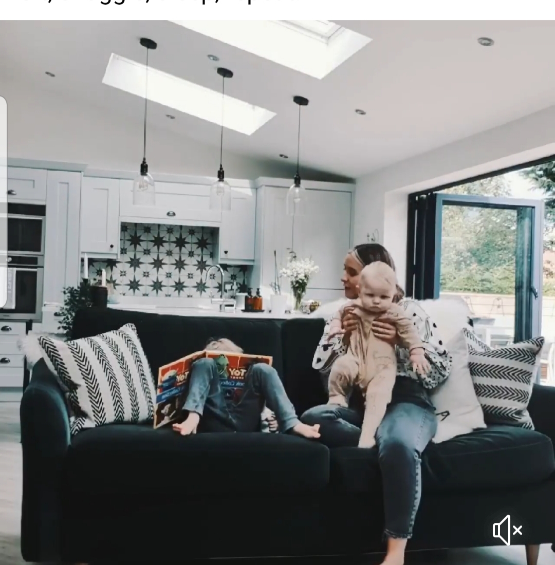

thanks! This is what I would like ideally. Not sure if my description of vaulted ceiling is correct? The pitch is only 15 degrees. I've seen several pics like this so I assume it can be done somehow?

As TTC mentioned, you need to create a warm roof if you want to cut holes in it for downlights. There's both thermal and vapour barrier issues otherwise.
Thanks aptsys, so it's cutting holes in the plasterboard that is also an issue, not just cutting the insulation? I've seen insulation coverable LED lights? Sorry if I'm banging on I just had my heart set on this type of lighting but obviously need to do the right thing and don't trust our builders for advice at all :(
Our plans detail a 50mm counter batten to create a void under the insulation for lighting.
A lot of builders/electricians I've seen on youtube and also on friends extensions seem to cut out the insulation around each light. Presume building control didn't get to see it as it's not really correct.
