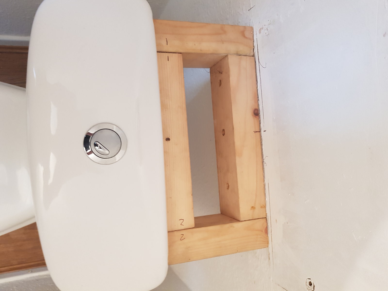

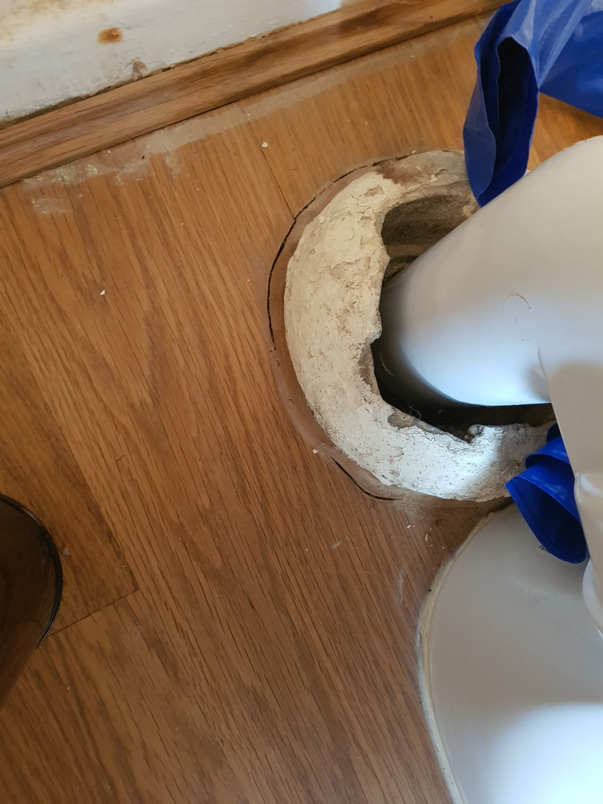

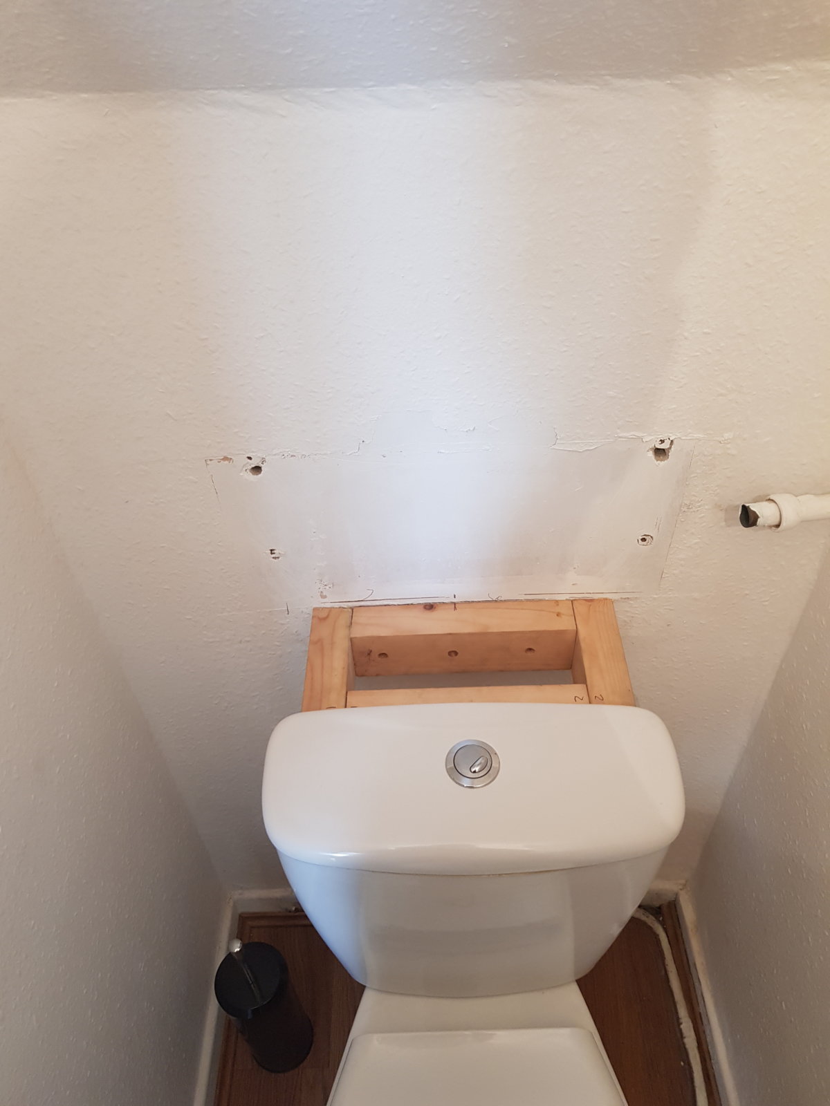

Hi all,
Not sure if this is the place for such a question or ideas but I'm abit of a novice in diy And new to the site.
Need some advice recently changed our loo downstairs bit of a cowboy job unfortunately.
1. The old hole was too big for the new toilet slightly and there is a gap. What can I cover that with?
2. How can I tidy up the back of the toilet where he's just put that bit of timber?
Thanks in advance.

What is the distance between the wall (excluding skirting) and the centre of the soil pipe hole in the floor? There may be a WC that will actually fit.
I am assuming it is a concrete floor so you can't easily alter the pipe below. If it is a wooden floor with a void it is easier.
You could use uvpc to form a shelf and clad the rear timber.
To hide the pipe make up a box and cut in half then cut semi circle in each half and push together around pipe.

To solve the issue.. Simply extend the timber to create a box frame down to the floor and left and right, if you so wish, and then clad the frame with either Mdf sheet and paint it or plasterboard and tile it.
We have a slimline Saniflo in our downstairs bog and this is how we hide it. You could do the same after sealing the waste pipe. Personally, I’d try to hide that fill pipe you have too.
We've done similar to Motman, using kitchen cabinet door fronts on the face.
Conversely, I bought a WC that actually fitted (it needed measurement and research, there aren't very many BO pans around) and has a skirt or shroud to cover the soilpipe connector, and fitted to the wall, so I had no need for boxing in. If you are willing to provide the measurement there may be a suitable one.

The timberwork looks excellent to me. It needs boxing in in some way, as others have suggested, but that may not have been in the installer's scope.
I would guess the outlet pipe has a seal eg chevron type or you would be getting smells up from the sewer. I would break out the old mortar, fill most of the space with packing of some sort, and finish off with cement mortar. Not too strong or too thick, in case it needs to come out in future.
