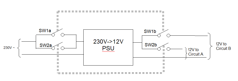

Given my uncharacteristically brief response to this question, I thought that I might as well explain what the immediate application (of a DP switch switching both LV and ELV) is all about ....
I have two bits of (related but totally separate) electronic circuitry, both requiring a 12V DC supply (voltage not critical). Both will only be 'switched on' (with a manual switch) very occasionally, so that it would make no sense to leave a 12V PSU permanently powered. The 'simplest' solution would be to just have two 12V PSUs, and for the switches to switch the 230V inputs to them. However, being mean, I wanted to do it with just one PSU - so, per diagram below, I plan to use two DP switches, one pole of each of them in parallel switching the mains input to the PSU and the other pole switching the output of the PSU to the appropriate load ...

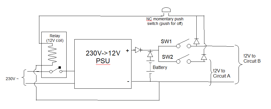

Given that I am perfectly happy with doing that, there really isn't any justification in trying to make things any more complicated. However, more as an academic exercise than anything else, I toyed with a way which would require just a SP switch for each load (switching the 12V output of the PSU) with a battery, some diodes and a (12V coil) relay switching the 230V input to the PSU. The below assumes a non-rechargeable battery (which could go flat!). If I wanted to use a rechargeable one, I would presumably either have to make the circuitry a bit more complicated or else use a battery which didn't mind being permanently 'floated' across the output of the PSU whenever it was on. I would obviously have to remember to press the push switch (as well as switching off the main switch) when I wanted to 'switch off'. However, as I said, I don't think that this degree of 'complexity' would be justified (if I were that concerned, I'd just use two PSUS!) ...

Or you could use a normal 3-gang 1-way switch - one gang to turn on the PSU, the other two to switch the 12V.
Ah yes, I forgot to mention that 'even simpler' (even simpler than having two PSUs) approach.
If it were 'just me', I might well have done that. However, having to operate two switches to turn one thing on (and, even more so, having to operate two switches when one turned the thing off, even though it 'went off' after only one of the switches was operated) would, I fear (even with appropriate labelling), potentially result in confusion (and mistakes) for some potential users.
It's also not a very 'nice/neat' solution - a bit like having to operate two switches to get a room light to come on (and having to remember to operate both when one wanted to turn the light off - even though it would 'actually go off' if only one of the switches was operated.)
