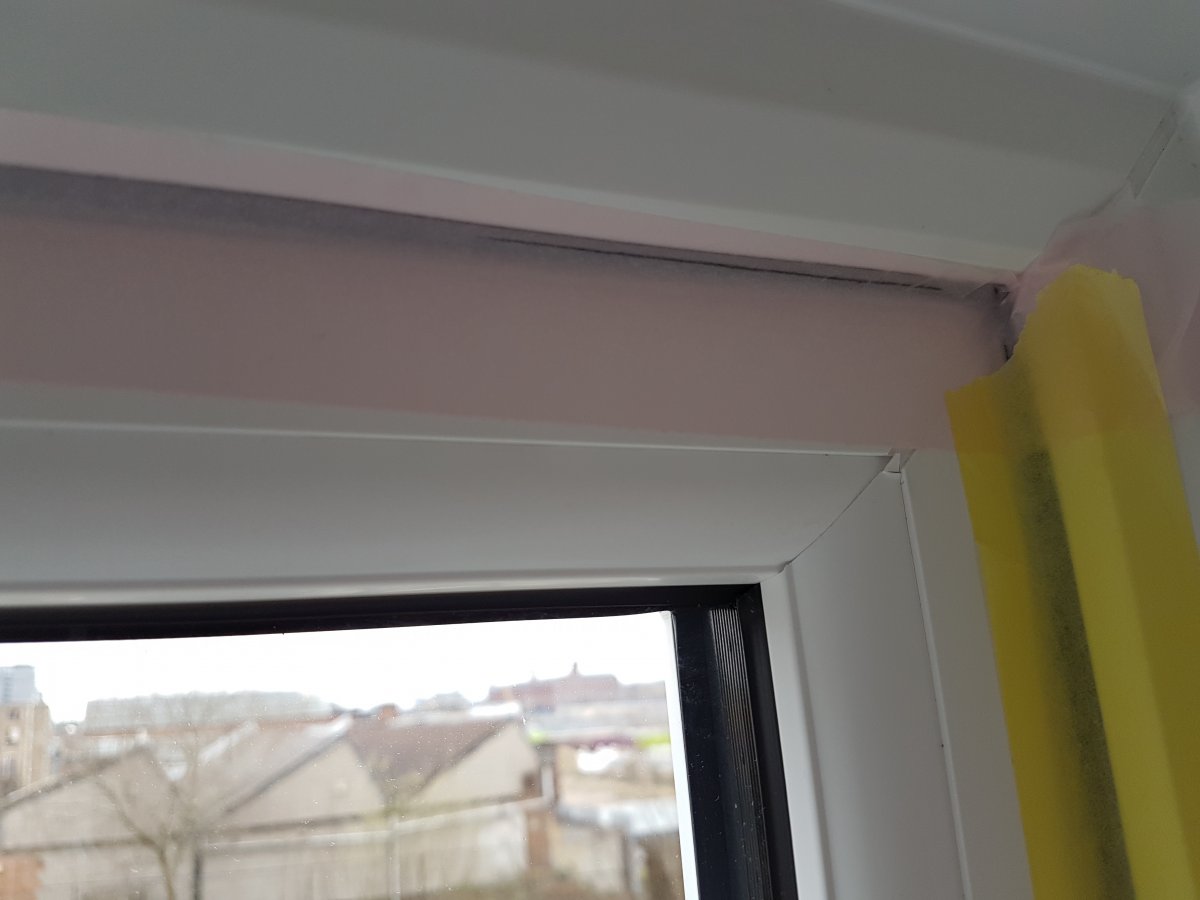

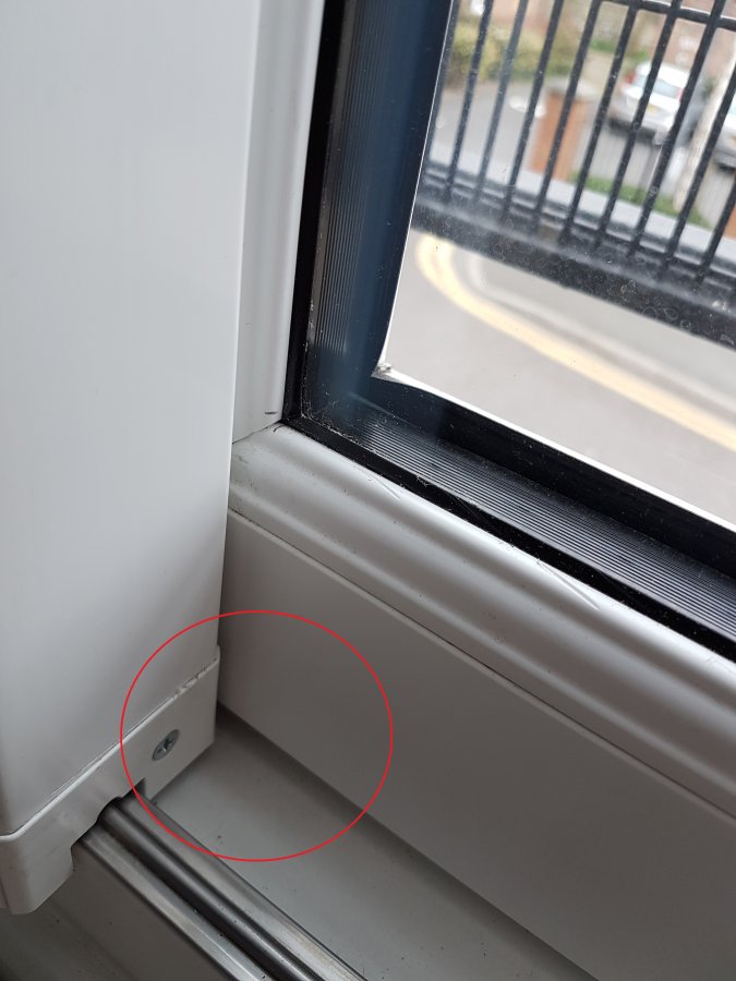

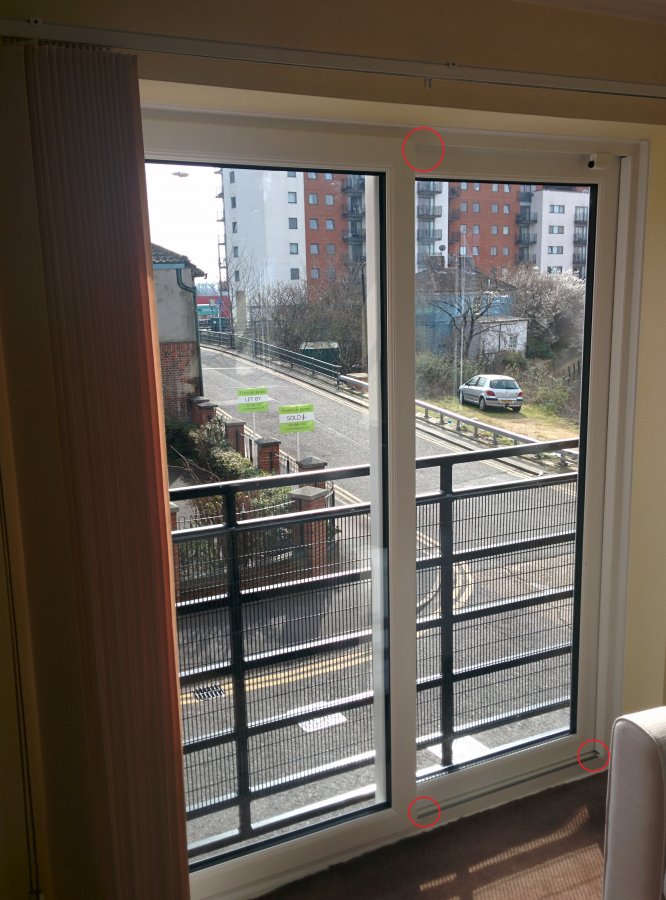

March last year I've had new pvc windows and door installed. Flat was in process of being redecorated and we really only noticed the problems when it started to get really cold around December. I've noticed a lot of cold draught coming from around the balcony door frame and window seals. I have heating on full and only able to get 19-20 degrees inside the room, 7-8 degrees right next to the balcony at night! I had to tape around the windows to stop at least some draught coming in ad I can feel it on my neck sitting on the sofa. (See attached pictures)
