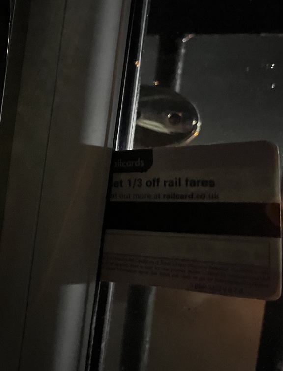

If you can slide anything between the glass and the rubber then something is wrong, suspect wrong thickness units for the type of frame
Well as you can see from the photo, I can slide the rail ticket in between the glass and beading, the ticket will insert upto 2cm.
