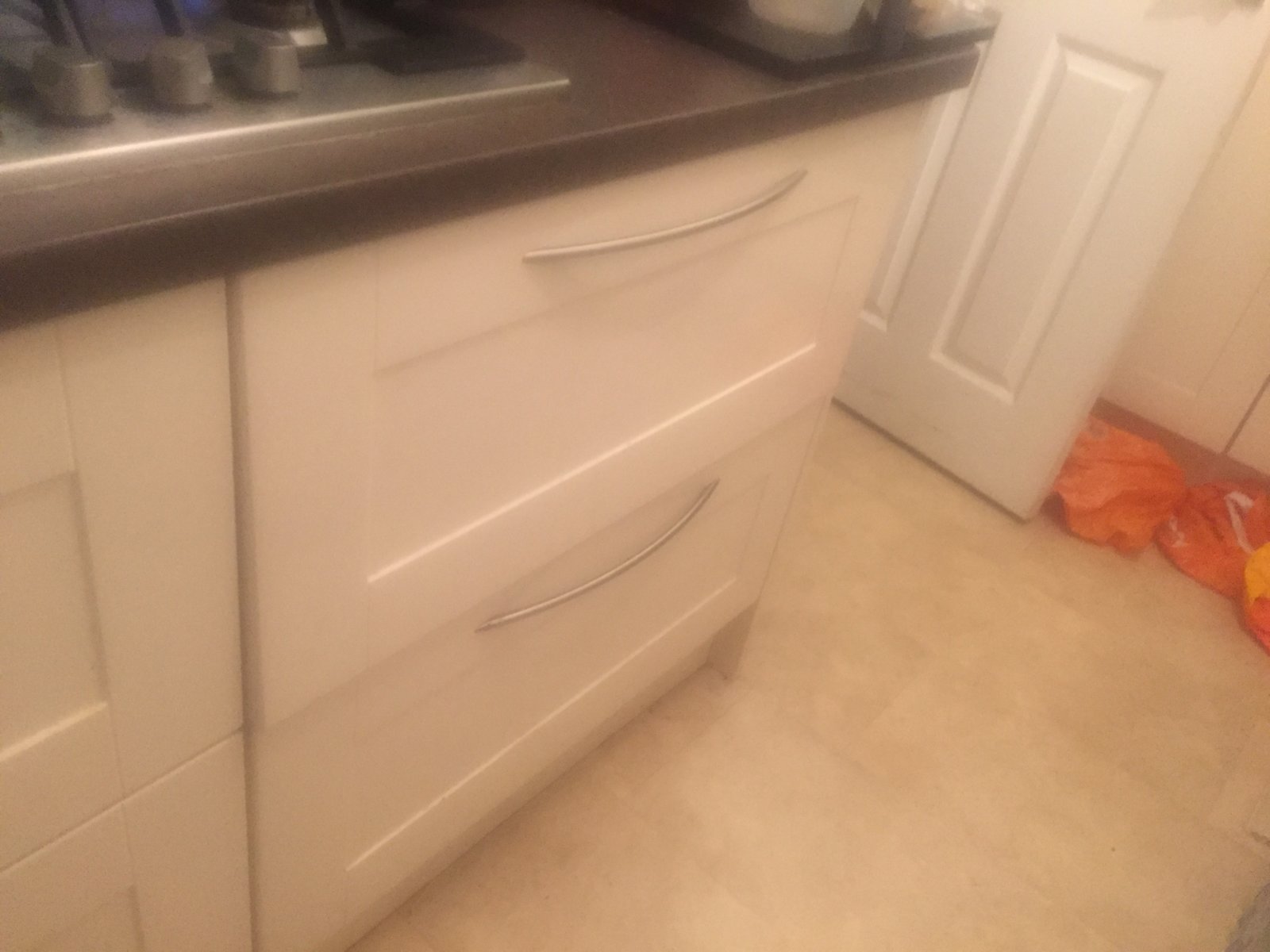

Drawer frontal damaged
They snap in on a heavy clip getting them off will require leverage and a bit of a struggle .
Maybe I should get someone in, as really confused now. When you say “they”, what exactly are you referring to in the context of my image?
The brackets which are screwed to the rear of the draw front ( one of yours is detached) they snap into the front of the drawer tray .
Thanks . Can see what you mean. So, with some pressure, I should be able to snap the whole thing off? What I don’t get is how that then enables me to reducer the bracket st the drawer frontal end.
I’m being really thick, so please humour me.

1. The end of the bracket is screwed into door frontal and those screws have come out.
2. I can unsnap the bracket where it fits into “front of drawer tray”. (I think), but not sure how I would then get to the two screws to tighten and reconnect? It seems like the end of the bracket is sealed, so could never get screwdriver to those two screws to tighten.

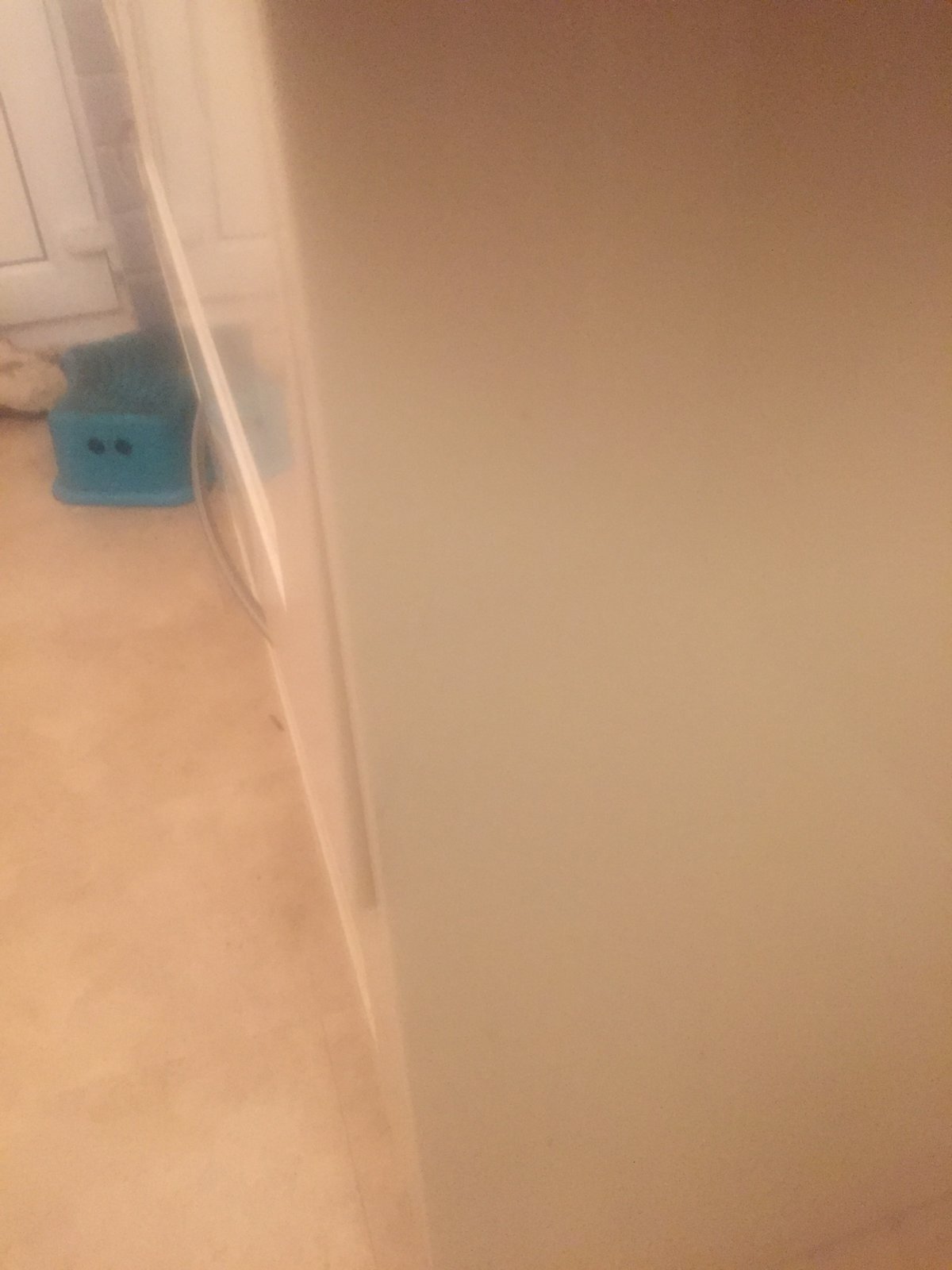

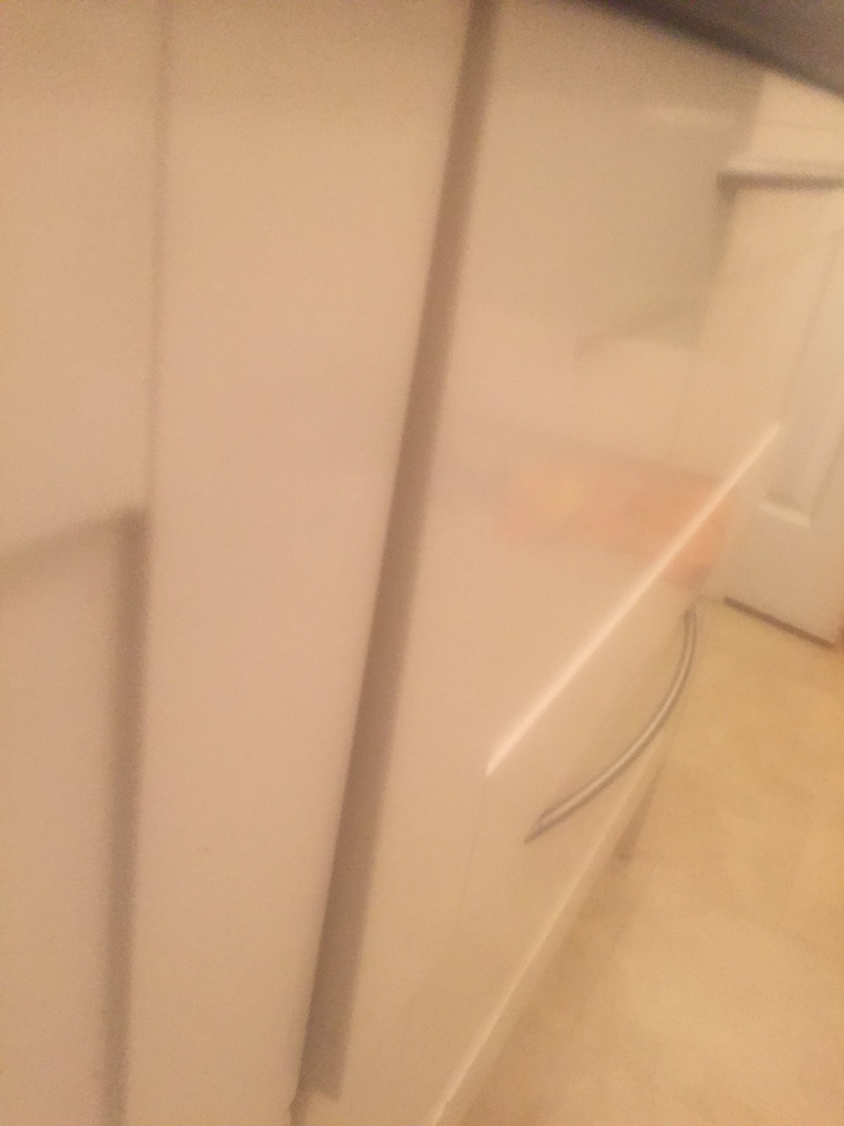

Finally managed to get drawer on. (With er indoors and son supporting)
I’ve reconnected the locking mechanism and poles. However, I think I inadvertently rotated one of the other adjusting screws, as frontal is now not flush with carcass. Do you know which adjusters I should use to rectify?
Think it’s probably the barrel adjusters on the poles, but a bit like playing Russian Roulette.
