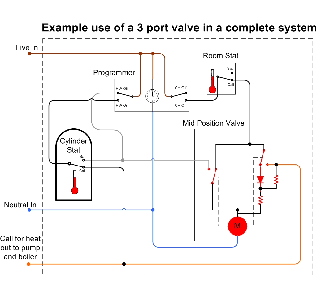

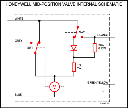

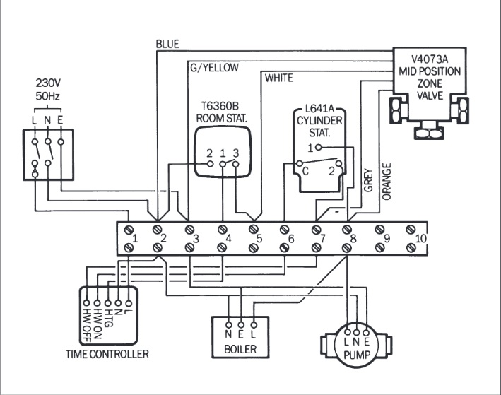

The three port valve is odd how it works, white is energised to get central heating, and it powers the motor half way, when the SW2 sends a signal down the orange to fire boiler. The grey is powered when you don't want hot water, John Ward has done a youtube video
The wiring
is here and as John says if the DHW is turned off when the central heating is running, then the valve can stick hard over, however if the programmer is left with DHW all the time, and the tank thermostat turns it on/off, next time the tank thermostat turns it on, the valve will return to rest.

Check your HW off wire is wired in correctly, it should be wired to HW off at the programmer and satisfied at the cyl stat, these two wires connect to the grey on the mid position valve

John Ward is on this forum as @flameport micro switches do stick, and also not all valves work exactly as shown. If the grey wire is not connected it will not motor all the way across, and I have seen many where either at the programmer or the tank thermostat the grey wire is missing.

As John says that diode can magnetise, and also means you need a type A RCD. But I have not worked with enough Y Plans to say if the being stuck wide open will cause problems in the long run.

How do you know that the cylinder stat hasnt switched off?, its heating the cylinder for 1.5hrs, the stat SAT, contact 2, should then provide 230V to the grey wire. Whether or which anyway, the programmer HW OFF contact should then (also) provide 230V to the grey wire and force the MPV to the CH position.
I know you say banging the valve makes it "work" but you might just consider programming the HW to be on from 0600 to 0900, the water will then be at its setpoint (60C?) and the cylinder stat, contact 2 (SAT contact) should then provide 230V to the grey wire. At least this would rule out the HW OFF contact as being the problem.
You might find the schematic, below. a bit easier to understand this very ingenious valve.
