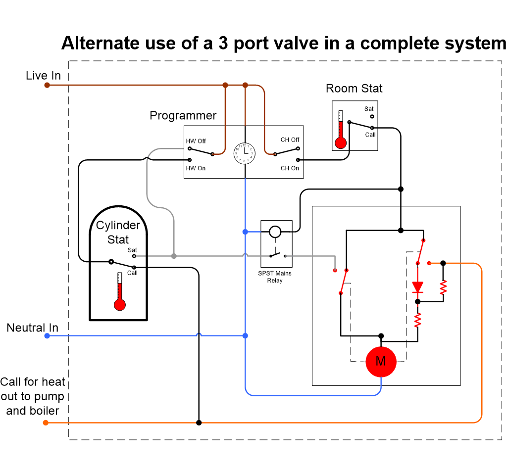

Drayton 22mm mid-postion valve woes
If I had a constantly failing 3 port I'd have long ago got ****ed off and turned it into S plan.
Also eph valves have a much longer warranty (5 years)
This modification wouldn't solve the above problem but the MPV might last for ever.
