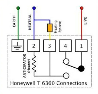

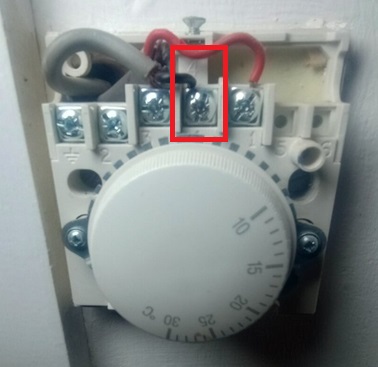

The whole thing looks odd to me. Terminal 4 of the thermostat wouldn't normally be connected to anything. Terminal 4 is a normally closed contact which becomes live when the thermostat switches 'off' as shown below.
However yours appears to have a connection to terminal 4. :unsure:
Also, no neutral connected to terminal 2. It will work without that and it's a fairly common omission, but it's accuracy will be affected. However at the moment that's a minor issue for you.
As for the programmer, as others have said, unless you can tell us what is connected to the other end of each of the wires there's really nothing more that can be done over a forum.

I think there still maybe a black wire going into terminal 3 from the cable with the red wire?
But who knows where that cable to terminal 4 is going?

As for your room stat same again you would only have a wire in terminal 4 if you have motor off valves cant see any wire in terminal 3 which is switched live for heating to come on
