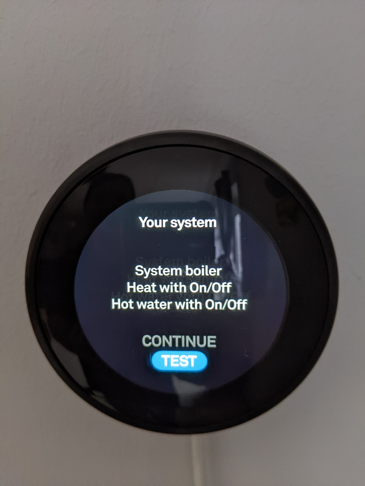

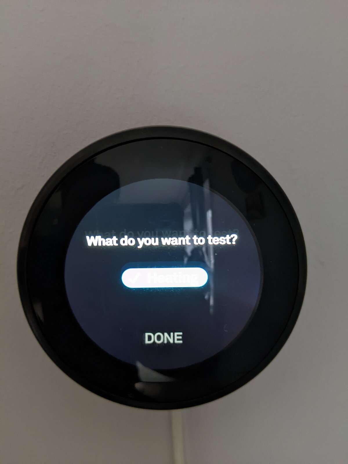

I have use the "testing heating" from Nest thermostat and it is work, the boiler status show "C" and burner light was on.
I am thinking if the heat function okay, the only possible problem of wire shoulg be the one at Nest terminal 6...
And i find that there is no hotwater testing on Nest thermostat, only heating, is it normal?

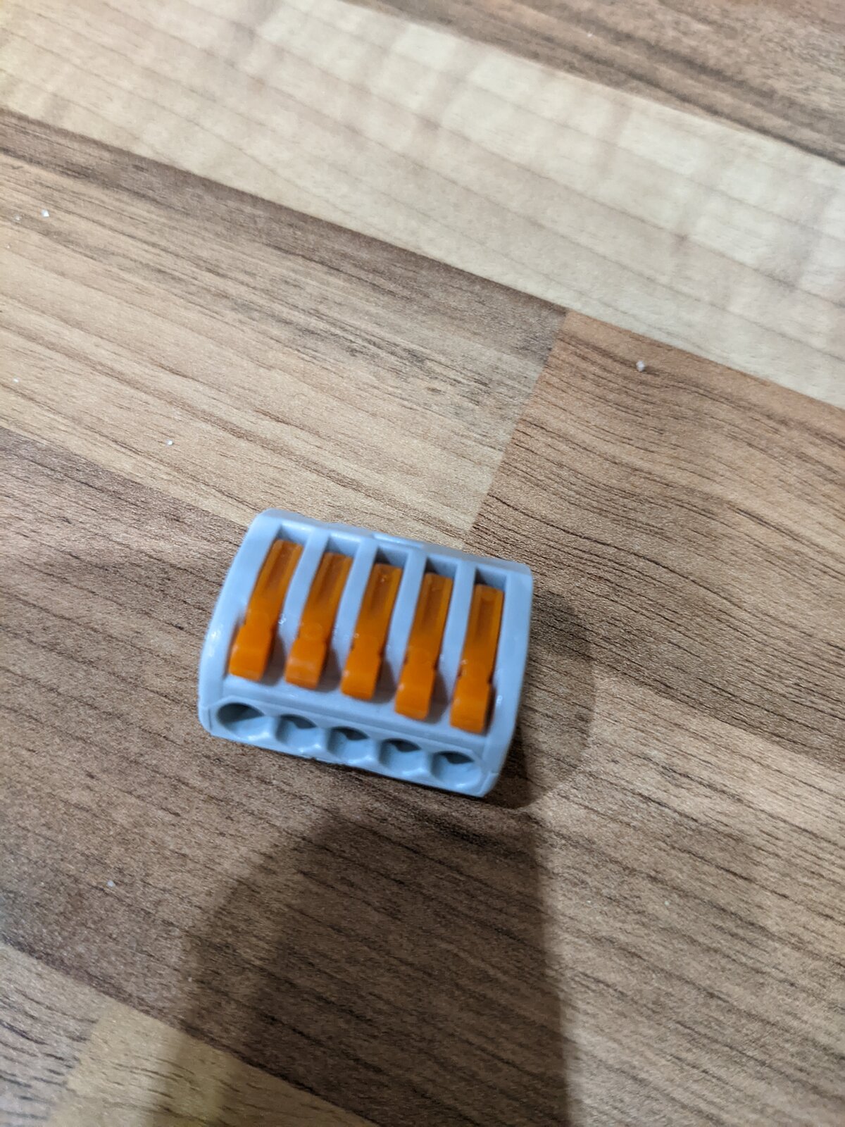

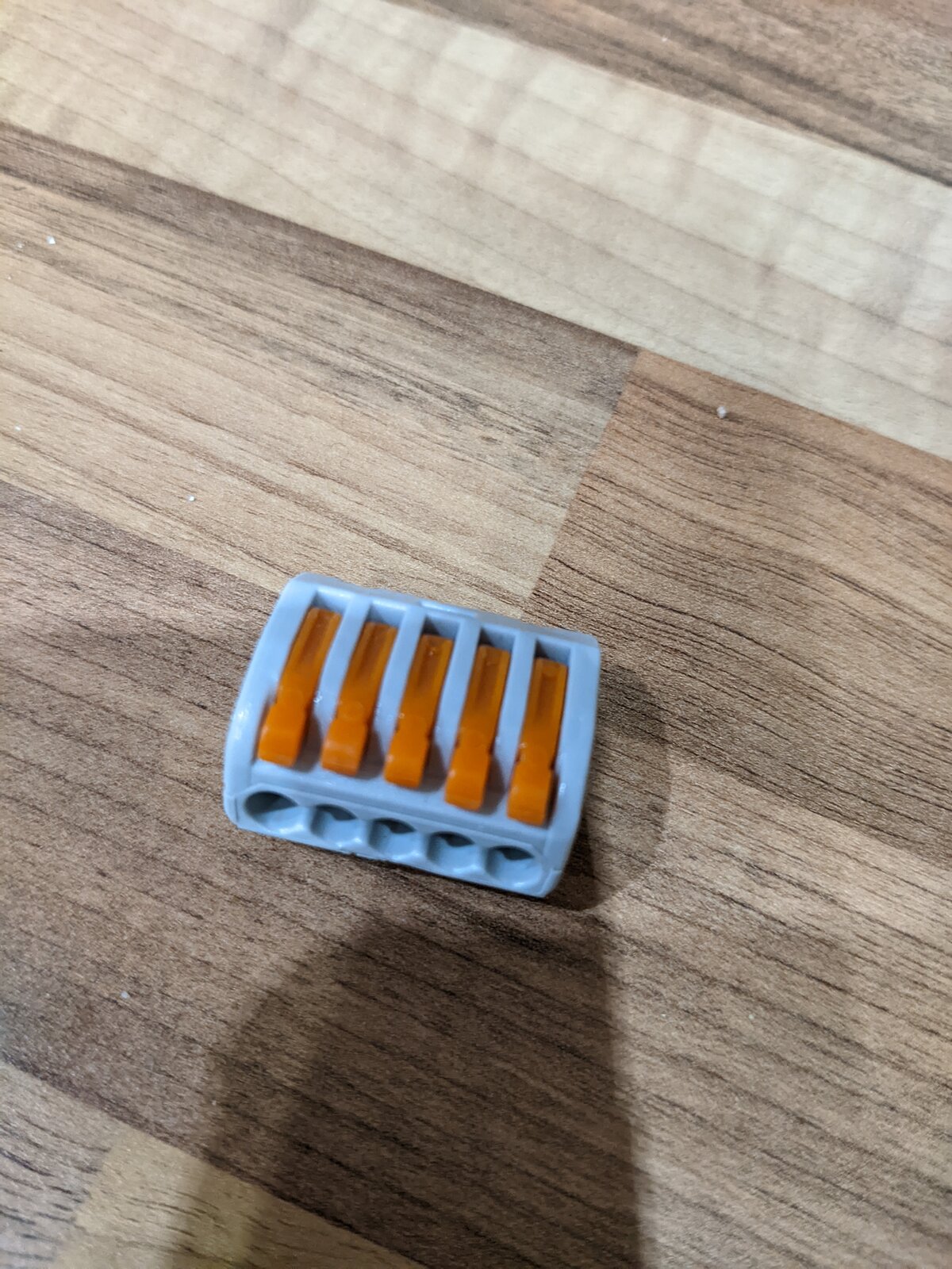

I found the problem finally.
i use this type of connector for connecting some of the wire together, and i have change the connector to a new one, and it's work!
I don't know how to say but just want to let you know i am really thank you for your help.
