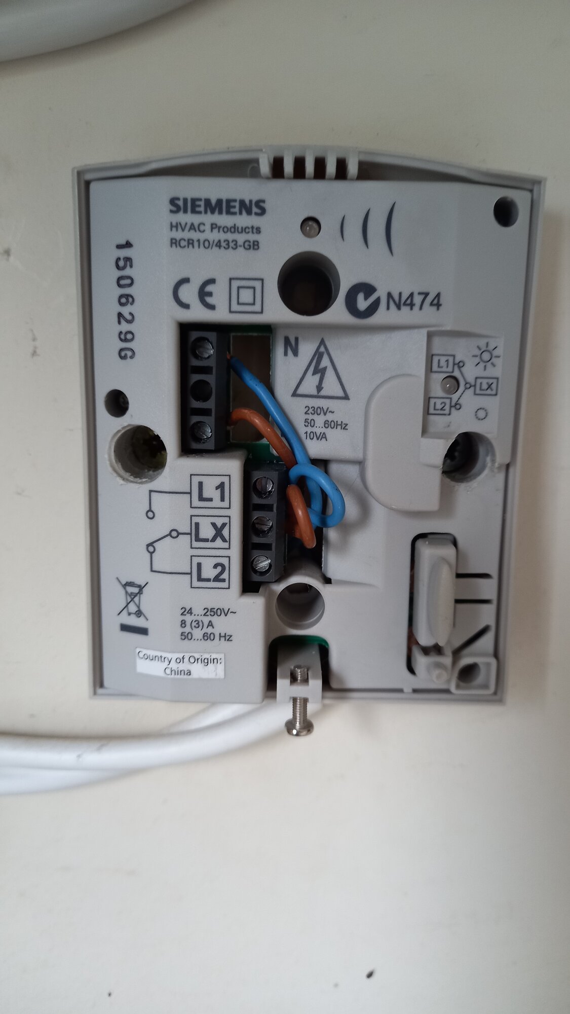

thank you....that has stumped me though...not sure which cable of the two that went to the RCR was heating 'on' but I did take a picture before disconnecting the 2 x 2 core cables. From the pic below, what one should I track to link the black to in the jct box. I have loads of pics so I should get it.
It should be L1 (blue) and I’ve just checked photo from jb and looks correct
perfect - for clarity - track back what was L1 (blue) from RCR to location in jct box and link it to the black in the jct box that goes to the backplate?

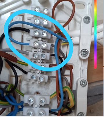

Can i just double check - circled in blue was the L1 from the RCR - so is it move the black which is just to the right and goes to the backplate so it connects to the grey where the blue L1 from the RCR was...hope i'm making sense...
Looks like it could be the brown then, which would connect to the black of backplate.
I think it's going ok.....Override worked so started to pair set-up the hub. I've only added the thermostat just now but a quick check with that once I upped the temp called on the boiler. The two sets of two core are gone but the black wire within the blue circle was moved to the immediate left which was where was L1 from the RCR was. So it is now the black in it's place and there is grey in the lower choc box connector that the black connects to. Seems ok but I've not tried to do much more and I've set water on but I've just moved into the house and don't fully appreciate the system. Big place with unvented cylinder etc. So I'm sure I'll have more fun and games.
