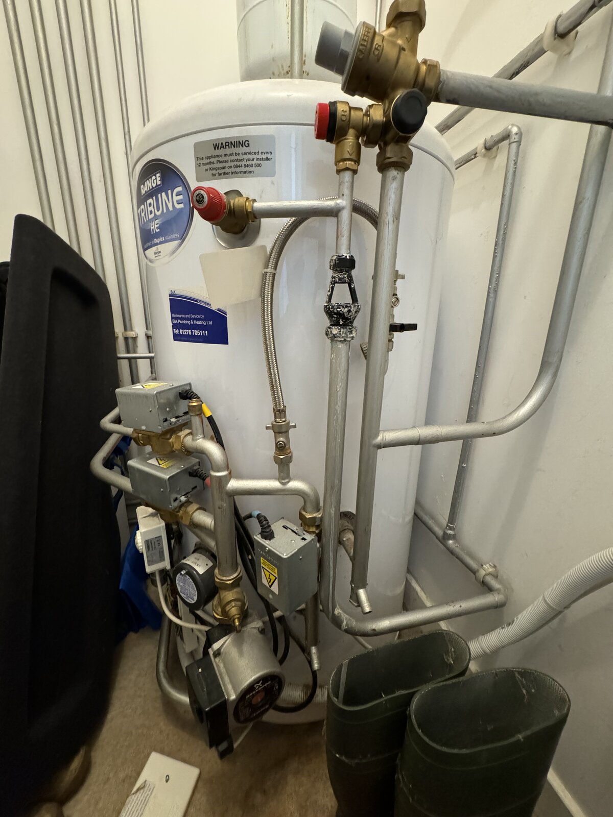

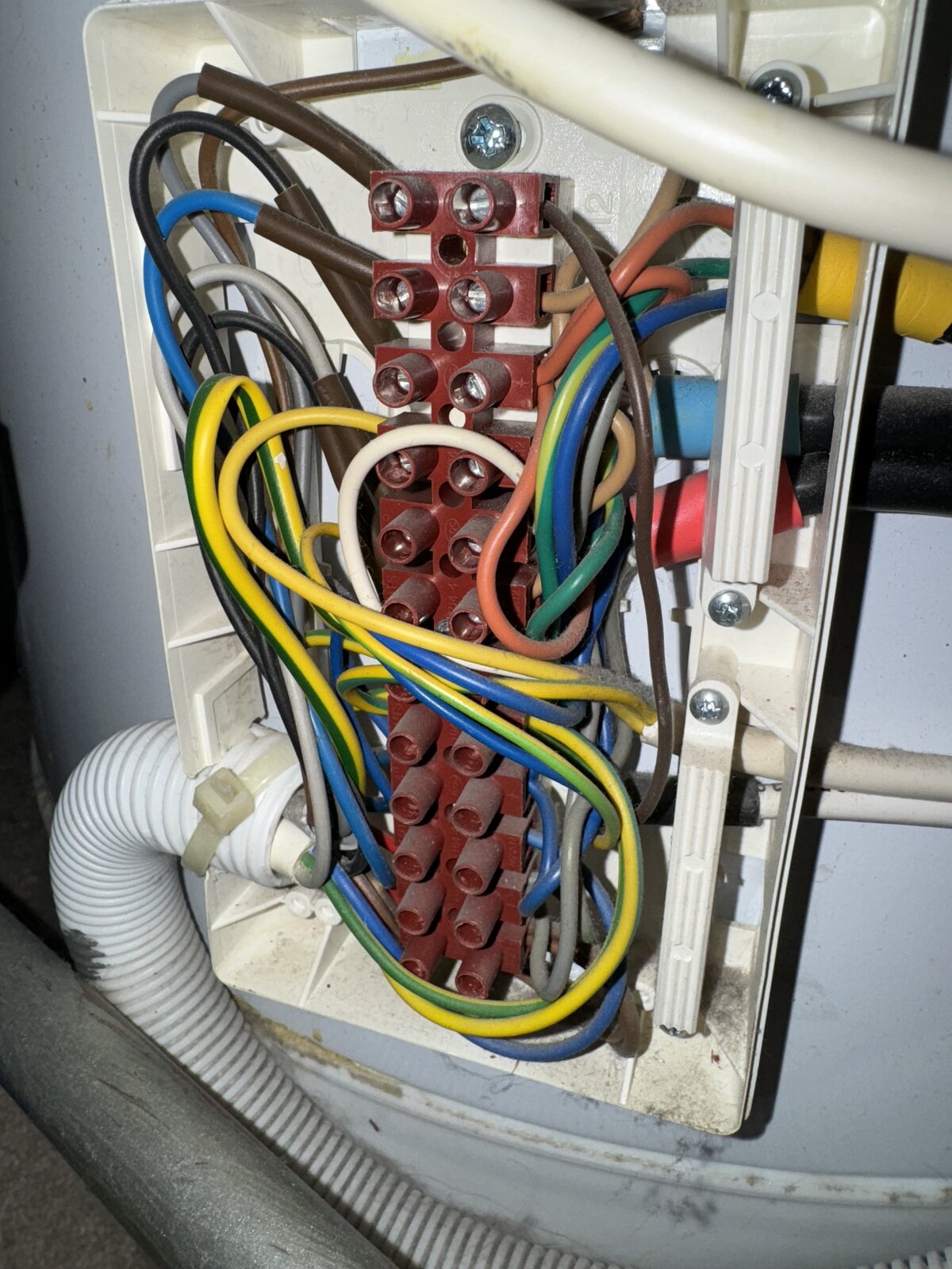

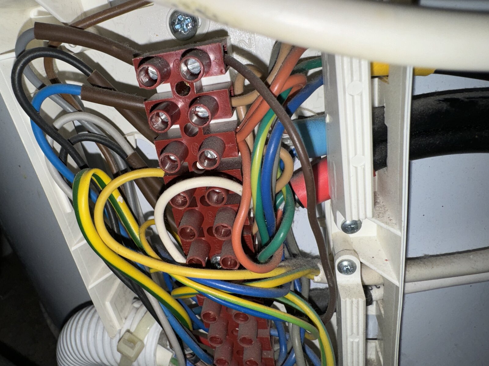

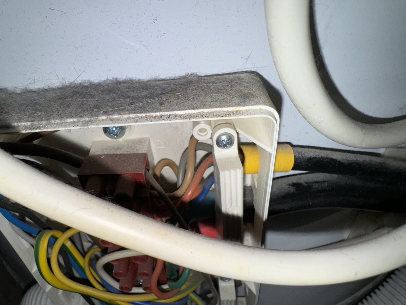

I’ve determined the zone, it’s the yellow valve. The red is the other/main heating valve. This has I think 4 wires, so is it a case of me plugging all 4 wires (based on their colours) into the same slots as the wires for the red valve? The box is a mess…
Sorry, I haven't got time to look at it now, but you should only need to move the brown wire. Check that the orange, grey, and blue wires are going to the same terminals anyway.
I think that should leave the existing Danfoss cabling redundant.
Great, thanks a lot. I’ll look for the brown - absolute mess in there so extremely hard to find it.
Spliced it with a connector as it was too short. All working fine. Thanks for the help, much appreciated!
