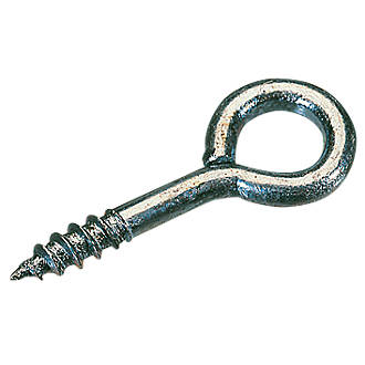

Thanks, I guess I could attach to a chain and mount to the top to allow easy removal in case i need to empty the chamber

Sounds like a good idea, I guess I could tie the rope to a bracket near the cover (drain chamber is about 1.5m deep or so)
courtesy of screwfix
