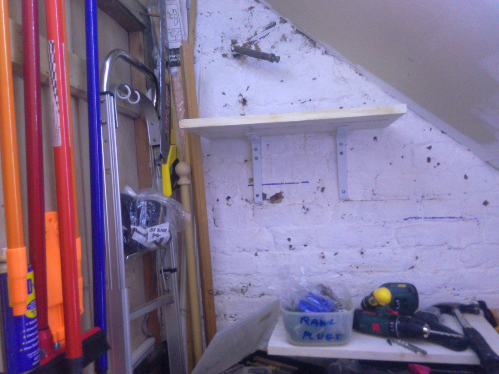

I'm putting two shelves into the cupboard under the stairs to hold DIY stuff.
Marked the wall four times with a felt tip pen through the screw holes in the shelf brackets.
Soon as I applied my hammer drill to make the first hole, the drill "jumped" an inch away from the mark without my being able to stop it, and the brickwork just crumbled and raggedy lumps tumbled down to the floor.
Obviously the four holes have to be exactly where I need them to be, to line up exactly with the holes in the shelf brackets.
I stopped after that one hole, to ask advice.
Thanks to anyone who can help.
Start drill without hammer action , prevents in jumping around, once hole started you can switch on the hammer action.
If brickwork is flaky start with 5mm bit and move to required size once you have position correct.
old red bricks, especially the ones used indoors (where they will be plastered and never seen) vary in quality and hardness, even in the same wall. They might be soft enough to drill without hammer (in which case keep withdrawing the drill to clear the dust or it might jam) and the hole is less likely to break jagged.
If you make a crater in the wall it will not hold a screw.
Most important thing is to drill the hole deep enough to insert the screw at least an inch. Tap the plasplug right in, and sink it slightly below the surface. If the hole is very ragged and the plug rotates when you try to screw into it, pull the plug out, clean out all dust, and inject a little no-more-nail or similar deep into the hole (put the nozzle right in). Push the plug in and leave it overnight. The next day it will be held firm and will not rotate or come loose.

BTW drill the top hole first, and screw the bracket into that, then mark and drill your subsequent holes.
Otherwise, if the first hole is out of place, all the other marks will be wrong.

I'VE DONE ONE! Well, sort of. There are actually 3 holes in each bracket. I have managed to get 2 fairly tight, secure fixings, 2 reasonable fixings and 2 utterly useless ones. But when I try to pull the shelf away from the wall, it does not move, so my bodge-work has been a reasonable success.
I used Foxhole's idea of a pilot hole, then a bigger hole.
After lunch I will have a go at the other one!
