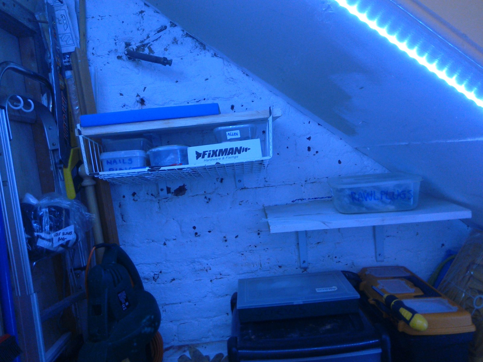

Drilling into bare, uneven 140-year-old red bricks.
Second one (on right) was MUCH easier. "Practice makes perfect."
Used three drill bits, each bigger than the last, on each hole; brown rawlplugs, and the biggest screws that would fit through the holes in the brackets.
It's been 2 whole minutes now and they have not yet fallen down!
New rawlplug collection sits proudly on shelf 2.
#girlscandoitforthemselves

These Fischer plugs you know......the flange on the end means they can't be pushed in too deep and are more resistant to a hammer blow
They are splined to stop them turning
Try them and you won't use anything else.
Well done! 10/10.
John :)

Cheers, John.
Had a look at the Fischers on Amazon and wow they are horrendously expensive.
These had good reviews, what do you think?
