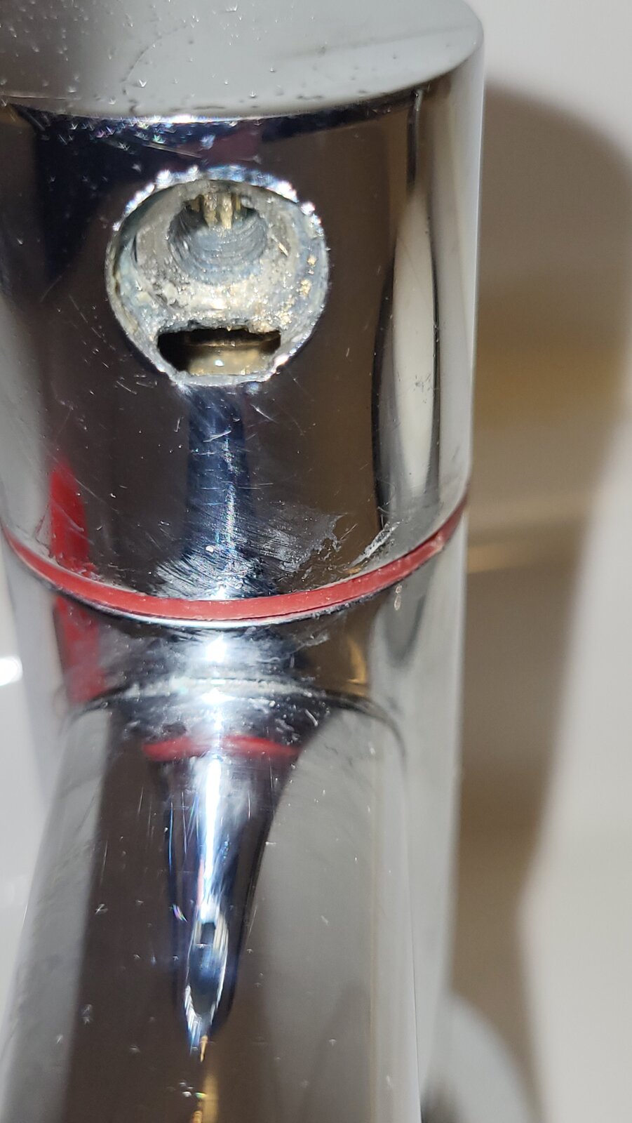

I think you need some brute force. It looks like the crown pushes down on to the brass spline. You could possibly tap a wooden dowel in to the hole and try to tap it up. Alternatively wrap a leather belt around if and try to grab it with adjustable pliers, wiggling it as you pull it up.
