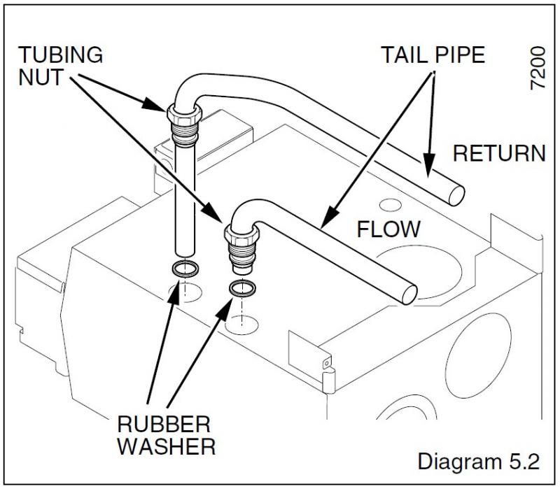

Anyway, I have two issues which I suspect are related. I have an unvented hot water system with a Megaflo tank and a Glow Worm Micron 40FF boiler. System is about 8 years old. Recently I have noticed a slow pressure drop on the gauge under the red vessel near the Megaflo in the airing cupboard. I have also noticed a very small amount of water pooling under the rear of the boiler in the kitchen. This mainly happens when the boiler first starts up.
I have spent a bit of time today working out where the drips are coming from behind the boiler and it turns out they are welling up in the tubing nuts where the flow and return tail pipes connect in to the back of the boiler. It seemed like the tubing nut on the return pipe was dripping more quickly than the one on the flow pipe, but they were definitely both dripping. The drip would form where the pipe goes into the tubing nut and then drop off the bottom of the nut.

Most likely!
You can see if the nuts will turn.
However most likely the system will need draining, the sockets cleaned with wire wool, silicone grease added and then reassembled with new "O" rings.
Its the "O" rings which create the seal and not the tightness of the nuts!
If leaks like this are left for a while the metal becomes corroded and it can be almost impossible to repair.
Thats why regular servicing is so recommended to prevent problems.

Should be picked up on a service but not a serviceable part, are they o rings or flat washers?
Hmmm not so sure, if a boiler is water tight at inspection, I wouldn't expect an "engineer" to dismantle all the water holding parts to inspect the washers! Otherwise a service would take several hours and cost as much too
Its not a problem with boiler normally and the "O" rings last the lifetime of the unit.
Its not possible to do anything apart from to just check that it is not leaking during the service!
Tony
Think tony and I agree, are they o rings on that particular unit?
