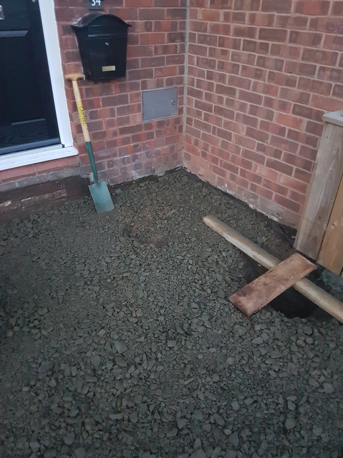

Well they started today amd manged to get all the grass up and all paving, the grass was lower than paving but they havnt really excavated much this may be becasue already has base were the block paving previously was and at end of day one they have base down and only a sprinkle ontop of were the origional base was ?

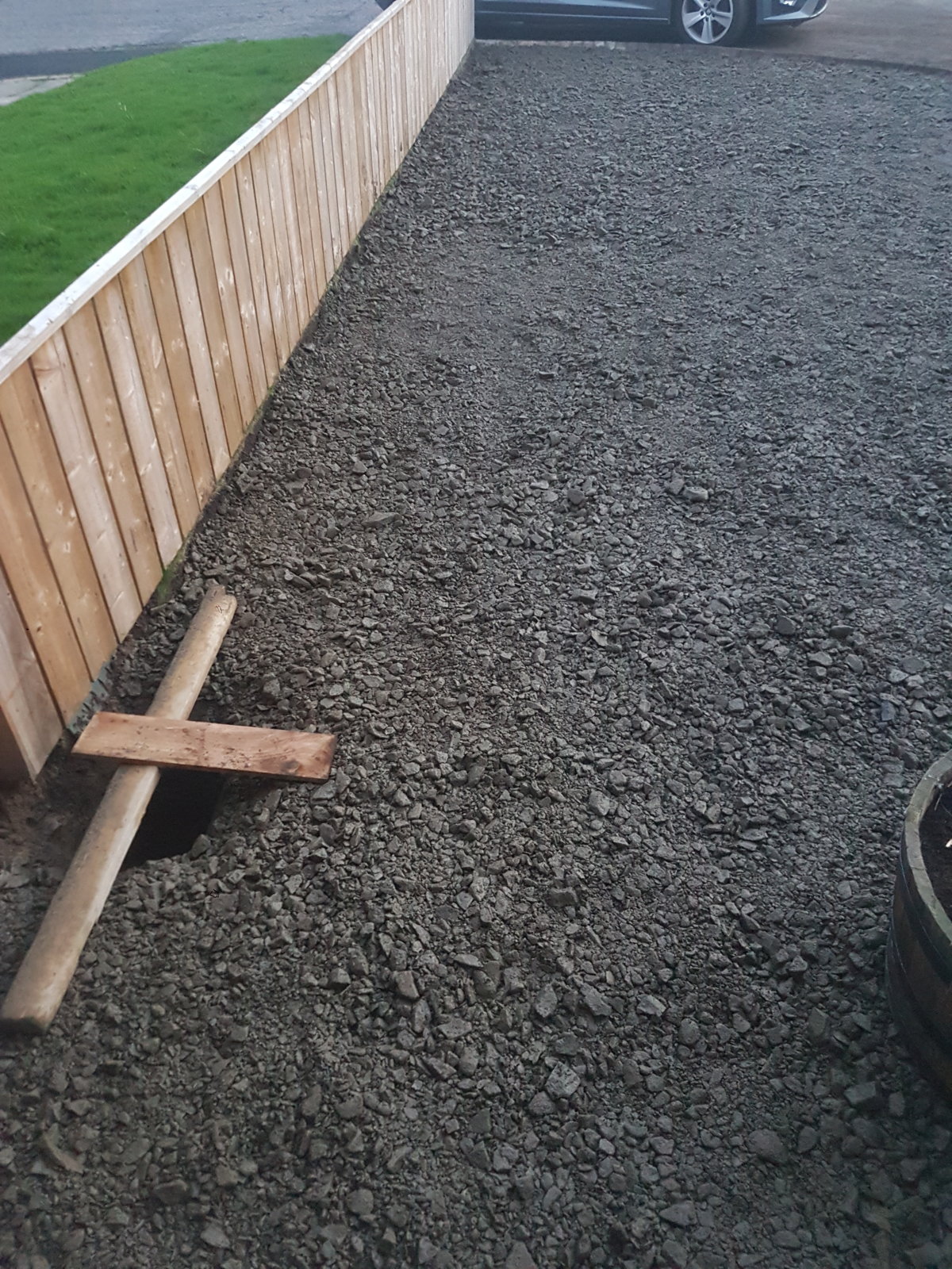

Its a few inches deep and 30cm below damp proof and 20cm on other end as on a slope. They have also dug a 2foot deep hole 1.5m from house as in pictures is this the soak away ?
Just a bit concerned as didnt really excavate much just dug out slightly, unless they are raising the drive up. Also you think more base will be coming tomorro or will that be it ? Said should be done by friday

There is a good few inches of base but just didnt add much on the side were the old paving was. Also want to check as if that hole is the soak away should be 5m from the house. I will post pic below of the sump.

I'd expect the original hardcore was fine as there newish houses.
there using a grab lorry, this means its being tipped legally.
dodgy traveller type paving companies use small tippers and tip around the corner !!
looks fine to me. Just check the soak away ? Are they cutting into the storm drain or is the base the soak?
I suspect they have it sussed.
Thats good base material too.

Going to say i think need more stone though as only 10mm deep or so and maybe less in places but i spoke to him last night after worrying and says may need more today.
Dont think they are going into storm drain as were it is located wouldnt work. At the minute its a hole with hardcore at bottom? but not sure if a soakaway as not 5m from house and the owner said doesnt need to be but i didnt ask exactly what drainage device is being fitted. He is pavying me a visit today to put my mind at rest he said.

They have dug a hole 1.2m from house and added some of the subbase in the bottom it is around 2 foot deep and i think the aco drains will be going to drian into it i imagine.
