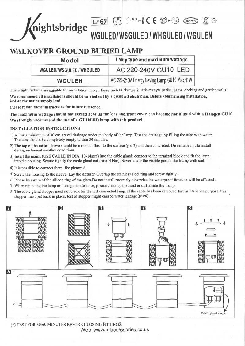

ok now I need a further help please...
I have laid the swa and looped all 6 lights back to the consumer unit. I have now also bought the light fittings but not sure about the glands and how to terminate the swa.
The light fittings have built in glands at the base 2 locations for 2no. cable entry, but will only take the 1.5mm/2.5mm cable and not large enough for the swa. There are 2 entry points at the base sides within the outer casing where the cable is supposed to enter horizontally. Given that these horizontal entry points are close to the vertical glands, my guess is that the armour is supposed to terminate outside, as the angle is too sharp to bend the stiff swa cable. The section between the outer casing and gland is not sealed and is open at the base, ie section of unarmoured cable exposed to water in the ground. Is this an problem?
Ok so my question is whether i need a gland for armoured termination at the outer casing as the section between here and the gland is not watertight?

Lights are not installed yet and just want to understand how it will fit together.
I have attached the instruction sheet as perhaps i did not explain myself property.
Just need to know whether i need additional glands to what is already supplied.
In my view the armoured cable is just there for protection and damage and not for any other reason, therefore does it really need a gland termination?
Yes it does.
The protection is not just mechanical, but also electrical when using the correct glands. If somebody was to dig and chop through the armour and into a live conductor, the properly terminated SWA glands will provide a continuous earth path through the armour.
Great thanks, i will then install glands to the outer casing and use the existing supplied gland for the unarmoured entry into the IP protected area.

If the units themselves won't take the cable, then you'd need to terminate the SWA into a separate sealed box and use a short section of different cable to the light fitting. This will be difficult for buried systems.
Putting aside peoples personal view on whether there is any point installing the lights, how do you connect a gland to a 15mm hole in the outer casing. Can you get a 15mm gland? or can i terminate the swa before the outer casing therefore have the inner cable go through the hole.
