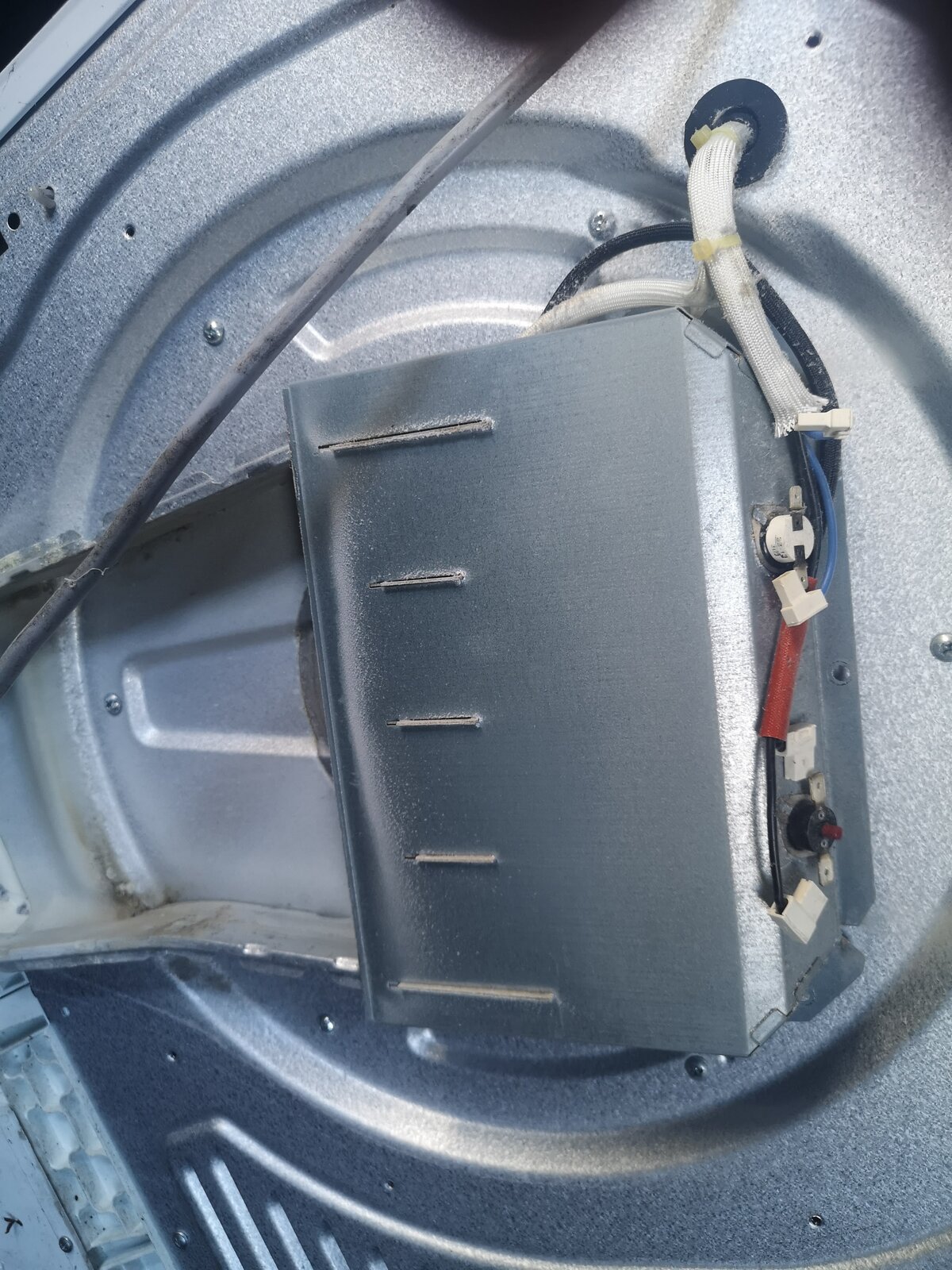

Hi all,
My Beko Dryer Condenser seems to be over heating and switching off.

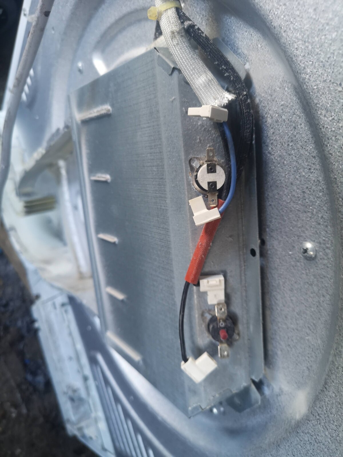

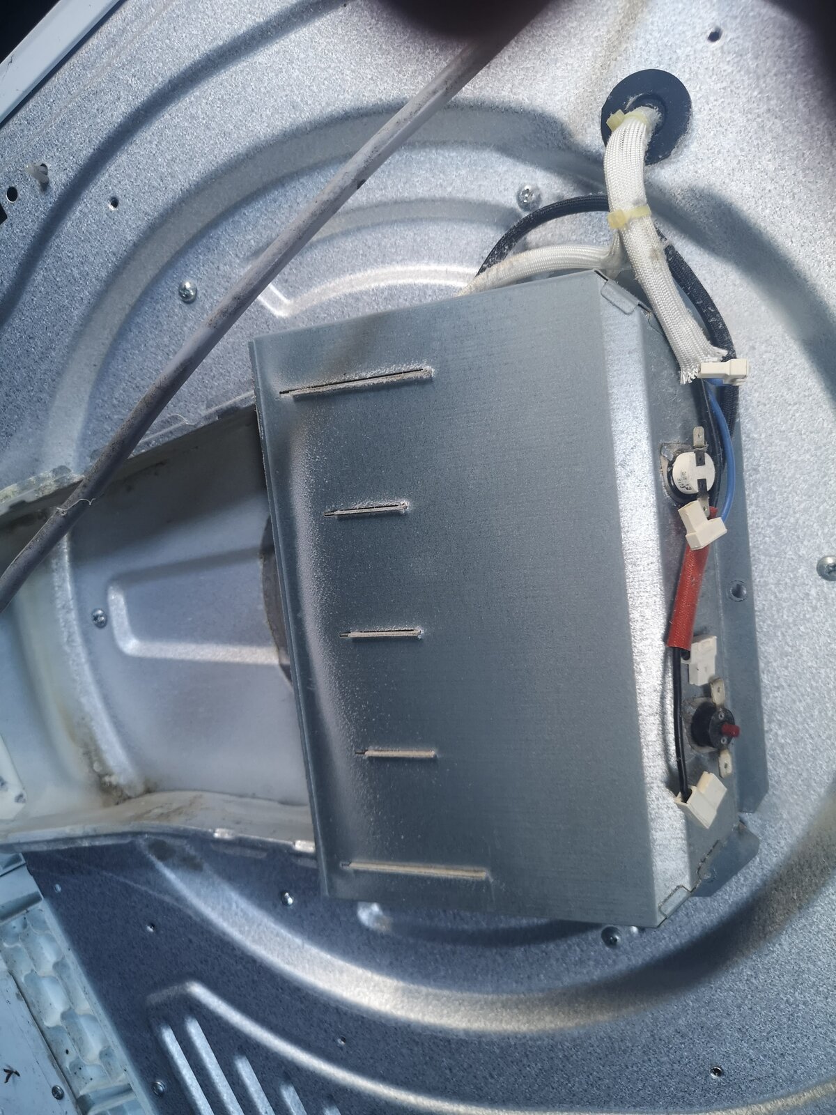

I removed the back panel (Beko) and tested the thermostat with my Multimeter (see photos attached).
With my multimeter at the lowest resistance mode. There was a reading with the black cable/black right side but no reading at all with the bliue cable/white side.
Should there be a reading on both sides? If so, I guess this indicates a faulty thermostat?
Cheers
Yes that would tend to indicate that the stat has gone open circuit and that one is non resetable in theory. However if you take it out and throw it face down onto a hard surface they sometimes do spring back to the conducting position.
Thanks, I give that a try, I guess this was the reason my Dyer was getting extremely hot after 15 minutes? and switching off, usually needing to reset one of my fuse baord consumer switches from off to on. I guess the trip is a Beko safety mechanism. Haven't had a problem with this dryer for about 7-8 years from memory.
Unless your condensor is blocked I wouldn't reset a faulty thermostat, it's a single shot thermostat unlike the resettable next to it.
If theres no blockage you would need a heater assembly with a pair of new stats.
well i dont think its a stat i think its a ntc sensor check with meter it will be in the k ohms
