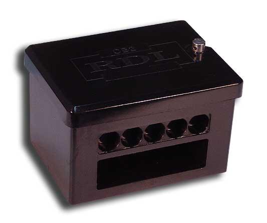

Hi,
I wonder if anyone can confirm whether there is a form of "splitter or Junction Box" available to allow a single Live / Neutral "mains tails" supply from a domestic electricity meter to be split in order to supply two consumer units.
The main CU is a split CU with both sides RCD protected.
The second CU is a 2-way CU with RCBO's to cover smoke detection / hall lights and a freezer supply.
Any help would be greatly appreciated.
They go under the generic name of 'Henley Blocks' although other companies make them too.
They can be single pole where two would be used, one for the live connections and one for the neutral connections, or you can get a double pole with one terminal strip for the neutral connections and one for the lives.
There are.
But I have to say that the fact that you have never even seen or heard of them shows that you are not competent to be doing any work which needs them.
Please get an electrician.
and also, you should have one common switch to dis-connect the power to the installation
There will be one in each of the CUs supplying each of his installations.
But if he doesn't have an isolator before those then I wonder how he thinks service connector blocks can safely be installed.....
