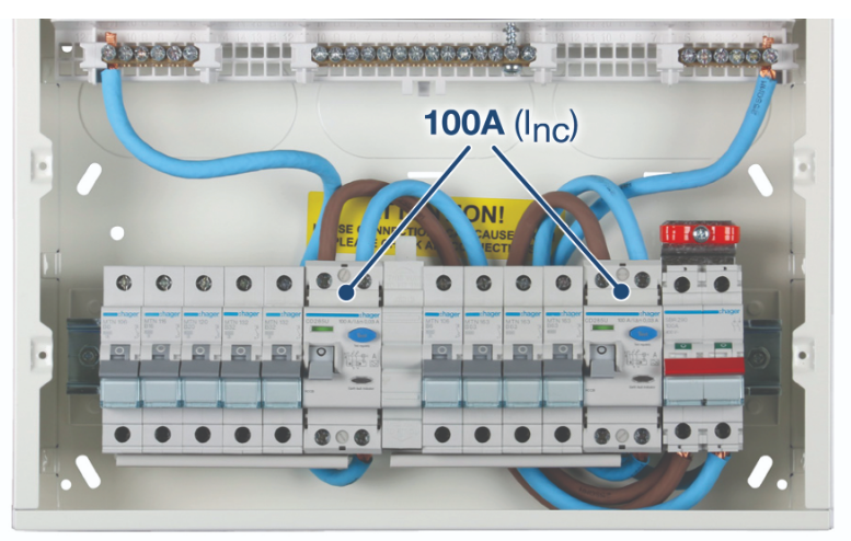

Separate circuit direct from supply to bypass main CU

Don’t worry I’ll be nice and safe. Just don’t understand why I’d not connect my new wires to the top of the main switch with the screw connection, rather than messing about trying to get them to sit in the clipped in bar on the bottom of the switch?
Please help me to understand if you can :)
Because you are supposed to have one switch that will turn off everything - hence the name Main Switch.
The bottom has screws as well.
I have told you to connect the new cable to the bottom of the main switch - which is correct for the above reason - but there is a way of doing this without actually accessing the bottom of the main switch. Can you work out how?
OK thanks for clearing that up for me. Makes sense. Way of doing it without accessing main switch? No sorry I’m not sure, could you expand please?
I didn’t see the screws, I though it was just clipped on to the bottom bar.
Here's a clue - the main switch is on the right on this CU and no supply yet.
Thanks. By connecting them to the bars at the top? But I can only see the neutral and earth bars? Live will still have to come from the bottom of the switch?
The main live and neutral wires which go into the two RCDs? So I could take the wires from the top of the RCD?
