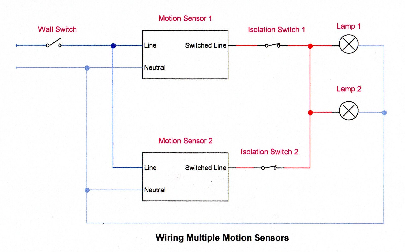

FWIW, the hack worked a treat :) Biggest issue was finding a couple of hours when I could work outside, when it wasn't raining. Thanks for all the help provided (y) Take care.

I currently have two outside lights, each with a PiR sensor. They have developed a fault so that the sensor only works some of the time.
This is an excellent reason for NOT using Lights with Integrated PIR sensors
I would like to replace these and reconfigure it so that I have two masters - i.e. either sensor can light both lights. Can somebody please advise on the wiring configuration? Ideally with a picture/diagram. Thanks KK.
My recommendation is to use two (or more) PIR sensors and two (or more) lights.
Place the Sensors where they are needed and
the Lights where they are needed,
making sure that the Lights do NOT shine on and affect any Sensor.
A suitable (basic) circuit is this :-
Installation of the "Isolation Switches" is recommended, since it makes it easier to adjust each PIR individually without "sensing" by the other PIR "confusing the issue".
Yes I did some like that, linking switch of the PIR outputs that could be switched off for setting up purposes makes it easier. Plus if you like to sometimes use them as individual units.
You just need to verify that the outputs are thru relays rather than semiconductors which can cause a lock up on some types.
Actually if you already have the wrong type and don`t want to change them you could go to the addition of relays (probably needing a seperate housing and conductors, if space within the units is limited) .
