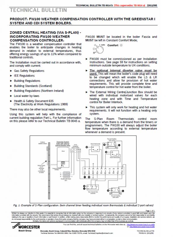

My post giving the link is for WEATHER CONTROL WITH MULTIZONE from a WB technical Bulletin.
URL removed picture added.

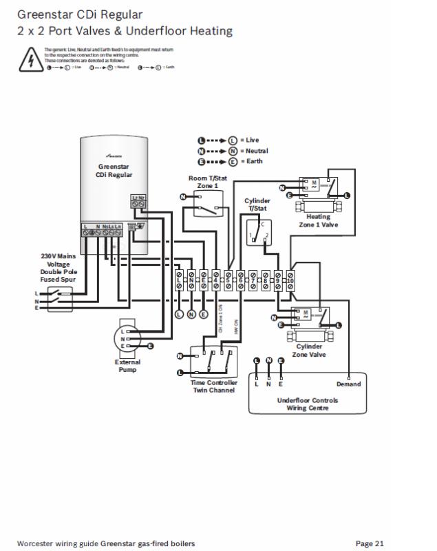

So I'm assuming it does what it says on the tin. No doubt that it won't be the Full Monty with all desired songs and dances but surely you can hang an UFH area onto an S plan layout.... This diag says you can

the wb technical bulletin is a bit lacking....they dont do two port valves in germany!
me neither....why would you if you can buy boilers with the valves in side...

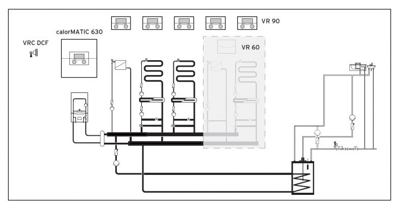

Vaillant's 630 and VR 90 controllers seem to be intended to control multiple variable and constant temperature zones.
There's only one catch; they're not available in the UK.

the vr 90 is a modulating controller...so the un mixed circuits are actually compensated but higher temperature than the mixed circuits...

Have you installed a VR90 or VRC 630, or seen one in the UK?

I believe that with the EU Common Market, you could buy stuff (boilers, controls, cars, sausages, etc) in one EU country and import and use in them in any other EU country, knowing they'd comply with all the local regulations. Is there anything to stop an installer, such as yourself, buying Vaillant, Viessmann, etc., controllers in Germany or France and installing them in the UK? This is assuming you could read the manuals and the controller had an English language setting option.
Shown as UK products in Vaillants Commercial boilers book www.vaillant.co.uk/stepone2/.../commercial-heating-brochure.pdf
Purchase VR90 from http://www.bhl.co.uk/product/VAILLANT_VR90_REMOTE_CONTROL_FOR_GSHP
Purchase VRC630 slightly more challenging and expensive but available from http://www.hawkheatingsupplies.co.uk/Vaillant_Heating_Controls/Management_System/
