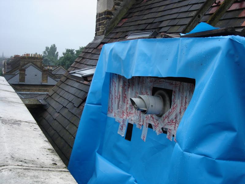

However my flu is only visable externally from the back garden. Is a visual usually done on these from outside while the boiler is on? Only he never went out the back.
