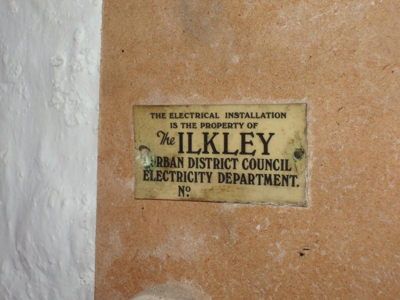

My somewhat useless initial photos were of a TN-S. The main earth cable was attached to the cable just before entering the cutout, with an earthing clamp. I requested the system to be made into a TNC-S and was expecting just that. Instead I "seem" to have got a combination of the two. will post what I discover at the weekend.
Thanks again.
No you haven't.
You have a TN-C-S.
It just so happens that the sheath of your cable is connected to this.
Don't hold me to this, but IIRC, from memory, that cut-out does not have an NE link option, so I would hazard a guess it is TN-S. But who knows what the DNO have done. Only they will know!
I stand corrected! :oops:
Thanks again.
As RF has said you now have TNC-S (PME) but out of interest, why did you want it changed?

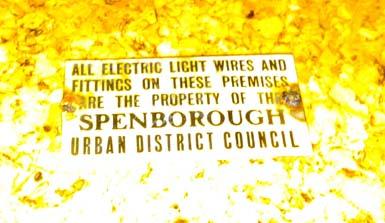

I think I can beat that, the plaque on the backboard next to my cut out is probably even older, it says:
"All Electric Light Wires and fittings on these premises are the property of Spenborough Urban District Council."
Spenborough Council ceased to exist in 1974 but judging by the wording on the plaque there was only lighting intended to be used in the house, this would also backup the fact I have only got a 30amp supply with a fused neutral in VERY scary fragile ceramic fuseholders!!!!! I don't think the cutout has been changed since the house was built in 1901...
It would appear that DNO supplies are the most outdated in the Yorkshire area, seem to come across a lot of dodgy old cutouts round here...
