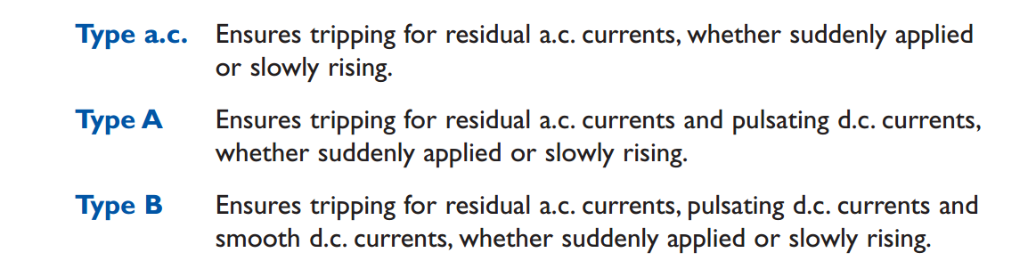

Yes, I know that and that is what Stillp mentioned but that's is not what's being talked about here, is it? The type 3 in the picture (page 1) relates to the MCB part, surely.

The relevance of this (stillp's comment) to this thread is that it seems that at least some treadmills may need a Type B residual-current protective device in order to avoid unwanted trips so, given that the OP has 'always had trouble with this treadmill', maybe that's his problem?

Don't Type B RCDs, put in the simplest form, detect more types of leakage?
I.e. won't it be worse - or no better?

Is it that the a/c part of a B Type RCD is better than, or can work separately from, that in the the normal a.c. or A types?
Never thought of it like that. I think (I'm by no means an RCD expert) it's just that the magnetic curve of the sensor is such that it doesn't saturate.
I don't pretend to know for sure, but my understanding has always been that, because (unlike A and AC types) Type B are designed to be able to cope with DC, that their function at AC is less likely to be messed up by the presence of (smooth or pulsating) DC currents. However, I may be totally wrong, so hopefully stillp can can confirm or refute.

I went a little further in my speculation, so I wonder if you agree with what I said - that it's probably because the Type B is designed to be able to cope with DC that it doesn't 'get messed up' (probably because of the saturation you mentioned) by DC in the way that an A or AC might?
