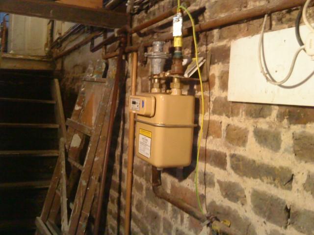

...and saw the gas meter outlet pipe had a 6 mm earth wire joining it to the consumer unit.
Tsk tsk Tony, it should be a main equipotential bonding cable, nothing to do with providing or maintaining earth.

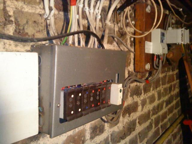

So, when do we get the answer? TT installation was gas pipe as main earth to the property would also be my guess, it's already been suggested but you haven't specifically confirmed or denied it. Not sure how we're going to tell, as with the info we have it's nothing more than a guessing game.
EDIT: Also, has someone bonded the incoming gas main before the meter?!
They've cross bonded the service pipe.

The gas meter is nicely earthed to the incoming gas main and into the consumer unit.
You can see the earth wire coming into the consumer unit at the top
Yep, so incoming gas main acting as main earth to the house, because as buck51 pointed out, there appears to be no other earthing back to the CU - be it from an earth electrode or the service cutout.
There's absolutely nothing wrong with earthing back to the consumer unit with your PEBs. In addition, although it isn't correct, the fact that the both the incoming and outgoing sides of the gas meter have been bonded certainly isn't immediately dangerous.
The immediate danger is that the entire house appears to have no main earth, which should be rectified as a matter of extreme urgency. If an electrical faults occur in the house, it could result in all exposed metal parts, be they gas/water pipes or appliances/switches, becoming live at 230v. Presumably, the incoming water also lacks PE bonding.
