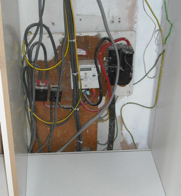

Right, just been looking at what I got, you can see I have a photo of the main in.
Now there are 2x 16mm earth cables from the collar of the Mains into the house, going up the wall to the CU's, you and see they are cable tied with the 25mm tales. There is also a brass JB at the bottom with a 10mm earth cable from the same collar going to it. Then two 10mm earth cables going up into the attic. No idea where they go as it is fully floored.
Now the mains water and gas come into the house 2 meters to the right, the other side of my back door.
So do I need to bond my mains and gass with 10mm to the brass JB or to the collar (looks Full)
Oh the elecy board put a new meter in last week, and added hundreds of cable ties :)
Have to ignore the mess, only just fitted the unit over the mains incomming.
Cheers
what the hell?
I see at least 2 sets of tails from those henley blocks ( possibly 3 reds, )..
what the hell?
Yep, I did explain the to Elecy People that did the meter, but the said its all OK.
From the meter there are tails to the blocks. Then from each block new(ish) looking grey tales, these are 25mm, going up the wall about 1.3 meters, one to each consumer unit. To me the tales look too long, but no one would change them. I guess whenever these where installed they did not have a CU long enough so used two small ones.
But I need to get this earth thing sorted. Any help would be great.
Do you think I need to get someone in to change anything?
Cheers/
You need an earth block like this:
5 wires into this block:
1 wire to the earth terminal (the 'collar' on the main supply cable).
Preferably 16mm, although this wire and terminal isn't actually your property, it belongs to the electricity company.
1 to the gas pipe, 10mm
1 to the water pipe, 10mm
1 to the 1st consumer unit, 16mm
1 to the 2nd consumer unit, 16mm
