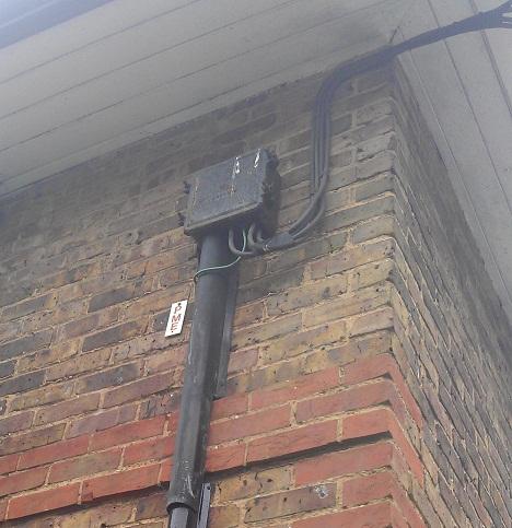

Currently we are supplied with overhead cables, we have a earth spike so assume using TT - the earth spike is uncovered and is slightly corroded. One electrician said he would replace & cover. The other didn't seem concerned (no requirement for it to be covered) and said it would be much better to get PME from the DNO anyway.
Incidentally the DNO has a PME earthing box on our house.

Some DNO's will not provide PME if the service drop the house is two single core cables (as in the ones in your pic). It maybe PME upto that joint on the wall, but whether they will give you a PME connection is upto them. Certainly worth asking - They may replace your service cable drop from that joint box to your service head as a matter of course.

The label on the box should signify that the neutral is bonded to the cable shesth at the box, the earth wire coming out seems to confirm this. That being the case all supplies fed from that box will already be PME, though they may not be connected in the properties (which seems to be the case)
Yes you need to talk to the DNO
Yeah, maybe PME outside, or even inside at the service head, but does not mean it is a PME installation within the property.
MEB in Staffs are good at this: They PME all the cutouts on the old TT supplies. But they only ever reinstate TT inside the house as that was what was there before they arrived....When I talked to an MEB guy he said they didn't want to take responsibility for having PME in a property where there may be no PEB's.

Thanks, DNO is fully booked at the moment, so have to call them back in June to book an engineer visit.
They said all they will do is test whether PME is available, they won't 'supply' the earth and that is up to the sparkie. Is that correct - I thought an electrician wasn't allowed to add the earth to the cutout?
They will test the earth loop, and I would expect they will then add a henley block connected to the neutral ready for your electrician to connect to.
Looking at your service head, you have a concentric drop and not two seperate tails which is good - My DNO will not usually PME a supply with the two seperate tails, only with concentric drops.
