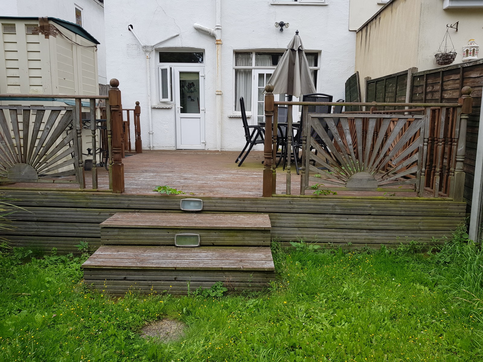

Hi all I'm not sure this is the correct place to post this but I have a question regarding the eaves height measurements on a sloping ground.
Basically I've applied for PD for a single storey extention 6m depth by 5m. With a max height 4m and eaves height 3m which has been approved.
My issue is my house (semi) is on a sloping ground so from the front of the house it slopes from left to right. In the garden we have decking directly outside the current kitchen which spans the size of the proposed extention. The decking has two steps before it leads onto the grass.
The shortest part of the decking is on the right 300mm when your facing the back of the house and it slopes to the left where the decking is around 700mm off the grass. So the highest part of the ground level is on the right. Lowest on the left.
My question is where is the eaves height measured from?. If it's from the highest part (defined in the technical guidance notes 2017) surely that would increase the eaves at the depth of the extention right?
At the same time of it's from the Lowest part i would have very low ceilings which will result in steps which I don't want as I'm planning to insert roof lanterns to include as part of the overall height.
You can see my adjacent neighbour has an extention already and he doesn't have any steps although his depth is only 4.5m out with an overall height of 3.2M.
Any help appreciated guys.
It's measured from the highest part of the natural ground level adjoining the extension (even if that makes the eaves higher than 3m on the lower side).
Thanks that was my interpretation of the technical guidance 2017 however I couldn't find anything online that confirmed this in a real life scenario.
