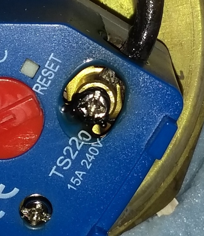

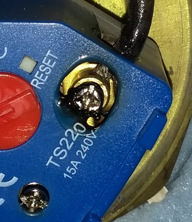

Or it might be the thermostat in the immersion heater, especially if very old. They are usually very easy to change (no water plumbing involved in the thermostat) but post a photo of it after removing the plastic cap
Er........bit of a smoking gun this time, and obviously not related to the blips we have had in the past.
Stat has had a complete melt down internally on one side, and had gone open circuit - which is a bit of a surprise as its a Tesla branded one, and probably only about 2 years old. The screws were tight too, so no obvious reason why it has overheated.
Thanks all.
