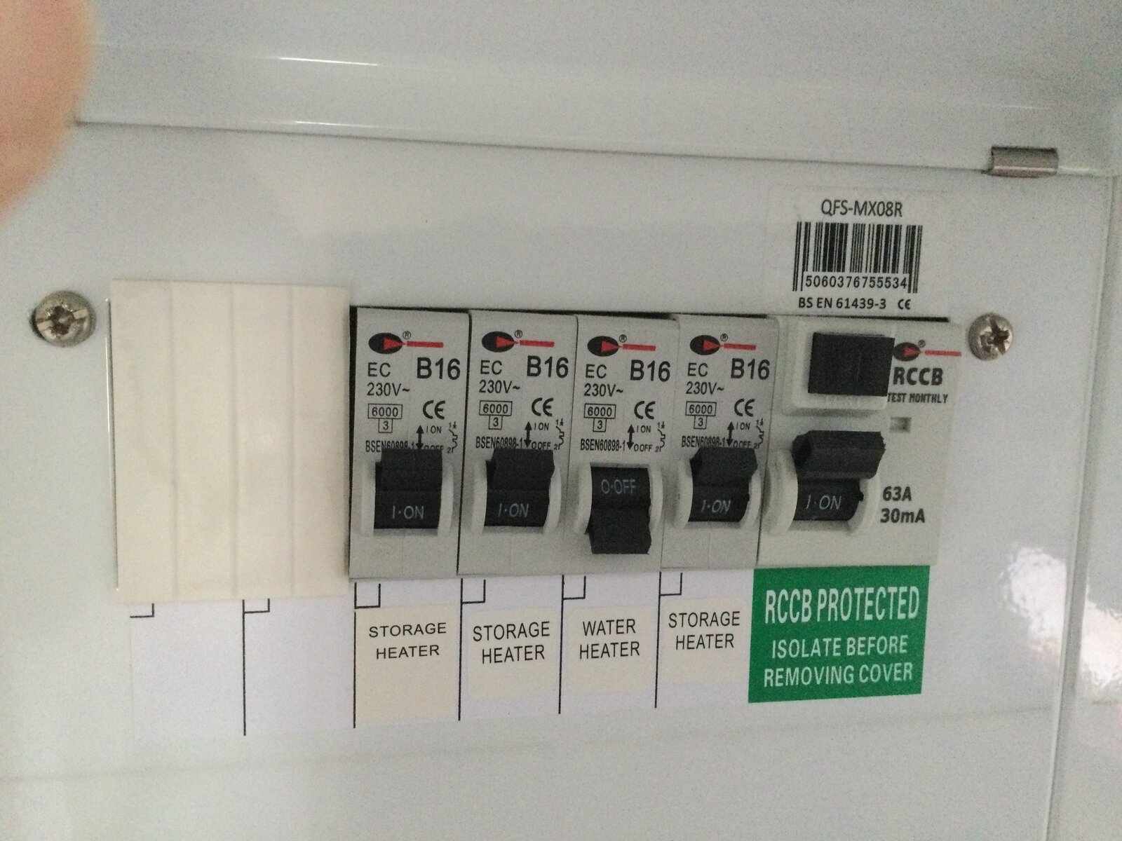

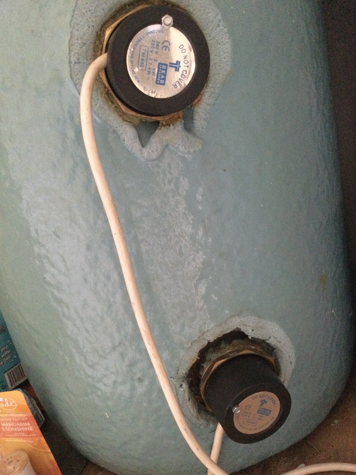

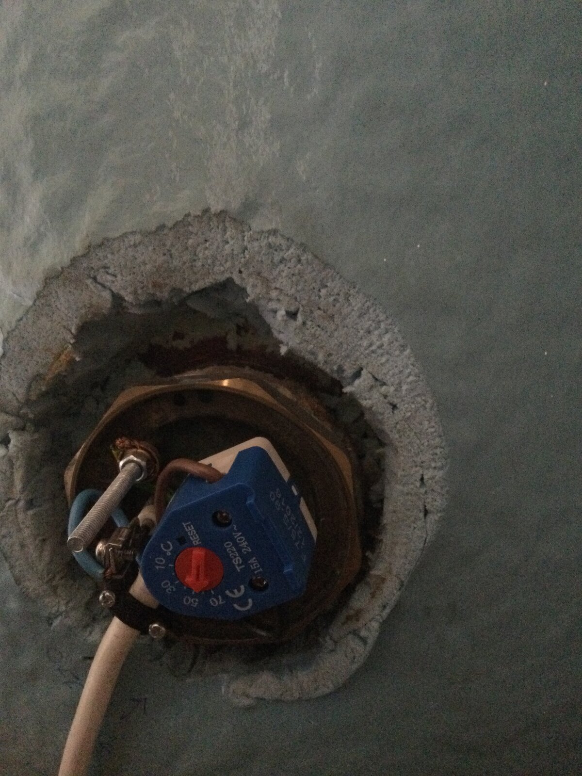

Economy 7 system. New distribution board. Plumber has changed the fitting on the tank twice. He says it’s the electrics and blames the electrician. The electrician says electrics are fine and it’s the plumbers fault. Result remains I can’t heat my water on a cheap rate overnight and I have paid two tradesmen with no resolution. Where do I go from here?
What is printed on the breaker that trips? All the letters and numbers please.
Some photos of the consumer unit with the door open would help. Include the meter, and the cables to and around the Consumer Unit(s) and the timer if separate.
Switch off (at the wall) every heater and immersion that is fed from the off-peak supply and the trip will probably not occur.
Then leave them all switched off except the lower immersion heater. This will verify where the fault lies.

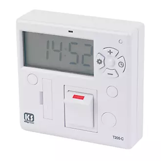

Economy 7 is a tariff not a system, when it first came out we had the white meter, and the immersion heater used for off peak was completely independent from any 24/7 heater. But people wanted to use washing machines and tumble driers etc on the off peak, so the system was changed, often it did have a radio 4 time corrected clock to trigger devices, but it was a trigger wire, or some times user set time clock to turn on the device.
We had a whole range of timers 1661757347068.png each one slightly different, some with one supply, some with two, and one has to read carefully the instructions.

I have had trips, tested the RCD which showed A1, and to make the customer think I have done something changed the RCD anyway, and faults stopped. Which seems to point to spikes upsetting some RCD's. It seems not all RCD's are equal, but it is simple enough for the electrician to work out if some thing he needs to do, or the plumber, if the element passes the insulation resistance test, then the electrician needs to correct any fault, and if it fails the plumber needs to change it, however the electrician would say the element is faulty and needs changing, not simply down to the plumber.
