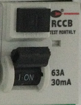

I am not a domestic electrician, I was always industrial so may be wrong, but this
Seems wrong for a new consumer unit, most RCD's have
or similar printed on them to show what type they are, the sign shown is for type A, not sure the date when this started, but my very old RCD's like yours don't have any type marked. Today we have type AC, A, F, B, S etc. Although type AC are no longer fitted, it is rather technical down to amount of DC and frequency and delays, which you don't need to know about, but fact the info is missing points to this being a rather old installation.

But as said that RCD seems like old stock to me, my old house no logo fitted 1992 with second hand RCD, not sure when the logos started to be printed on the RCD, maybe others can help.
Most likely wired incorrectly. Is there a timer / controller or similar where the immersion heaters are connected next to the hot water cylinder?
but this Seems wrong for a new consumer unit,
It is wrong. CGD branded stuff disappeared several years ago, it's all Lewden branded now.
Probably old stock that's been laying around for years. Type AC RCDs, which are no longer permitted for most loads from the end of September 2022, just a few weeks away.
