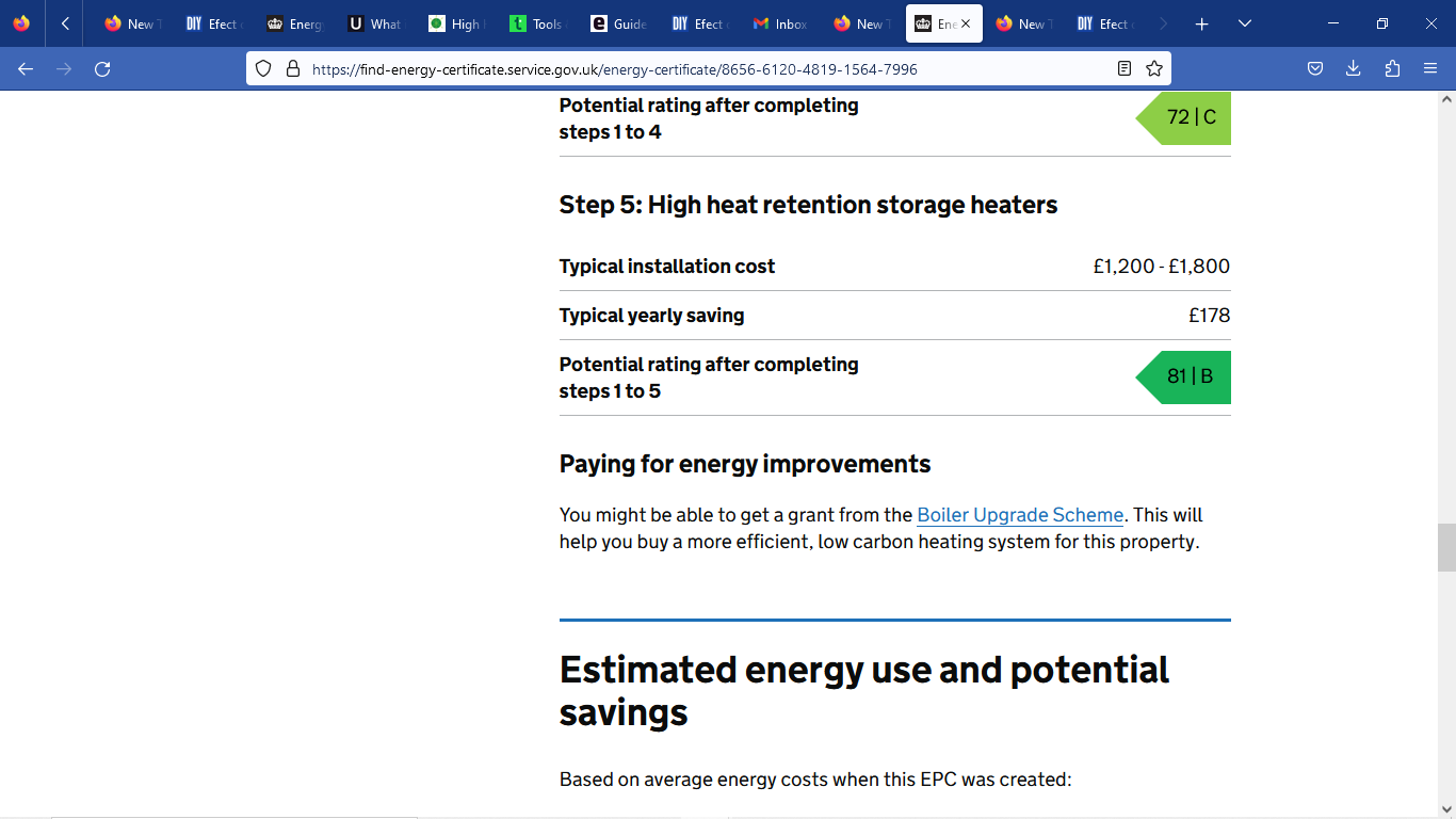

Hi,
I am considering buying a flat which has an EPC rating of 68 (D). The EPC was carried out 9 yrs ago and I am concerned that values attributed to the variables involved may have become more stringent.
https://find-energy-certificate.service.gov.uk/energy-certificate/8407-6422-6959-9740-7922
The flat has cavity wall insulation and simple panel heaters at the moment, not the 'warm air electricair' system mentioned on the EPC. Could anyone advise me on the likely impact on the EPC rating if I were to install High Heat Retention storage heaters?
Also, what would be the likely cost? I think I would only need 2 such heaters. One in the lounge and one in the bedroom.
As the flat originally had a 'warm air electricaire' system, am I right in thinking it must have had an economy 7 meter at some point and that reinstating this would be relatively simple and cheap?
Thanks, Chris

It does seem a very nebulous exercise Eric, I've been through most of the 68 EPCs relating to the flats in the development I intend to buy in and the same assessor, on the same day has given different ratings for the 'warmair electricaire' system the development was built with, from 'very poor' to 'average'. Most of the assessments were done on the same day - January 6th 2014, just after cavity wall insulation was installed and the warmair system in my flat was rated as very poor. I guess the 2 panel heaters that replaced the warmair system would be rated very poor too. My question is how many points would I gain if I were to go to the expense of installing HHR storage heaters?
Flat42's EPC history is interesting, It had an EPC inspection in 2014, as all the flats did when the cavity wall insulation was fitted, but then had another in 2016 where the assessor assumed there was no cavity wall insulation (?) but stated that installing HHR storage heaters would improve things by 9 points. I guess in 2016 HHR heaters were being 'pushed' by the software. and it may be that something else is being pushed now. I agree with you Flameport that the system needs massive reform. Standardisation would be a good start. After all, all I wanna know is what does the system want me to do right at this moment in order to gain the highest rating?

2x HHR storage heaters, associated items and installation won't leave much out of £3000.

So looking at my own EPC I can gain 2 with floor insulation, 1 with all LED, 3 with solar DHW heating, 6 for electric solar panels.
The house has two EPC one for the bottom floor, and one for the upper two floors, some of the entries are daft, the upper one has no reference to improving the domestic hot water with a 80 mm jacket around the cylinder, but the lower floor does, however there is no cylinder on the lower floor, it is on the top floor, so there is no cylinder to fit the jacket. The same with the cylinder thermostat.
The last house said 7 for replacing boiler with a condensing type, but next door same style house only gains 6, and next door but one, it says how solar DHW would add a point, but it already has it.
And next door to that it says how high heat retention storage heaters will save 7 points, I was unaware anyone on the estate used them, that house is E rated, all the rest are D rated so it seems electric storage radiators have a lower rating to gas.
