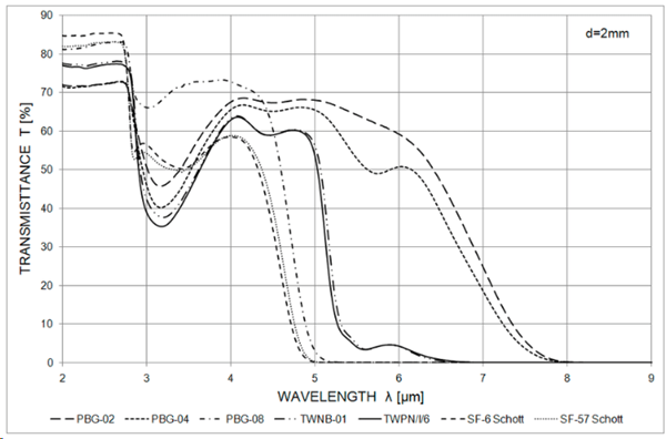

ordinary glass is not very transparent to IR
Glass is transparent to IR - it has to be specifically designed to attenuate the transmission of IR wavelengths.
and, presumably at least partially because of that, the glass envelope gets very hot - so most of the transmission of that heat is likely to be by local conduction
The glass gets very hot. What do hot objects do? They radiate IR. So really, it doesn't matter if the glass blocks the IR, gets hot and then re-radiates some other IR, or just transmits the original IR. It's radiating IR in either case [as does anything warmer than 0°K].
It seems plausible to me that an incandescent bulb transmits more heat by IR radiation than convection and conduction. But I don't know how to verify this and it might be faulty reasoning.
We went through all this quite recently. As I said at the time, it flies in the face of everything I have ever understood about "how/why greenhouses work".
I think that there is a lot of potential confusion due to the fact that the IR spectrum is very wide and that the transmission by all types of glass generally reduces with increasing wavelength. The graph in the link you provided (which is the first hit I get with Google) shows high transmission through "clear glass" over the whole region depicted, but that only goes up to 2,500 nm (i.e. 2.5 μm) - so primarily "NIR". There seems to be considerable variation in what people regard/describe as "thermal IR", but a fairly common view seems to be that 'thermal radiation' corresponds roughly to "MWIR", with a wavelength of about 4-8 μm (4,000 - 8,000 nm) If one takes that view, then the second hit I get on Google shows:
... which seems to show that transmission, for all the glasses considered, falls markedly as one moves through the MWIR region, done to almost zero by the time when gets to the top of that region. ... which might help to explain how/why greenhouses 'work'!
True, but when the hot objects are in contact with some material (including air) they transfer heat to that material by conduction (whence, if the 'material' is a gas or liquid, by convection).
As I said before, my suspicion, based on some theory and some 'experience', tends to be the opposite of that - namely a suspicion that only a small proportion of the heat transmission is by radiation. I've just repeated the 'experiment' I referred to - with my hand more than about 3-4 inches horizontally from a 100W incandescent, I struggle to convince myself that I can feel any heat,, but with my hand about 12 inches above it, it rapidly comes to feel quite warm. That seems to support my suspicion that most of the heat transmission is by (conduction-initiated) convection. I don't pretend that's any proof of anything, but it is certainly not inconsistent with my suspicions.
