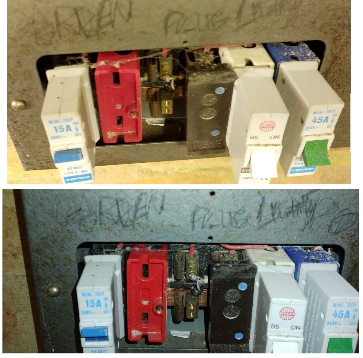

EICR opinion please
Missing fusebase / blank - (C1)
Missing 'spark cover' where - It is necessary to maintain a suitable IP rating (C2)
...............................................................and where re-wireable fuses are fitted (C2)
45A device in way not rated to accept it (C2)
Undersized wiring on 45A fuseway (C2) could be a C1 depending on what it goes to, looks like 1mm
No schedule or labelling (C3)
RCD is of type AC (C3)

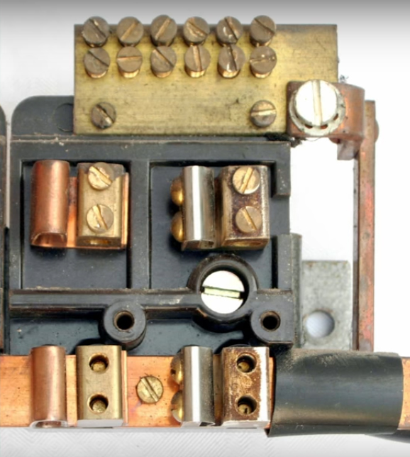

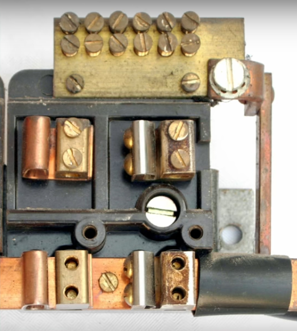

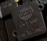

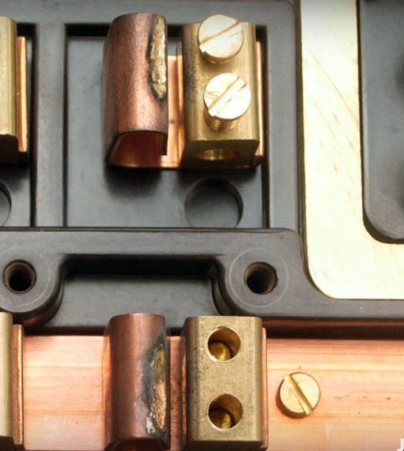

Yes the first fuse carrier was often higher rated Wylex heavy duty.jpg note the different colour of the spring, however this was because of the flash caused by removing the fuse which could cause this Wylex burnt contacts.jpg with a MCB it is not withdrawn while switched on, so not really a problem, and yes the main isolator was rated 60 amp, Wylex 60 amp.jpg however if the DNO fuse is over 60 amp, then really the DNO at fault, not the owner, it is very unlikely that an old Wylex fuse box has been fitted after a 100 amp fuse is fitted, the DNO should never fit a 80 or 100 amp fuse where the isolator is 60 amp.

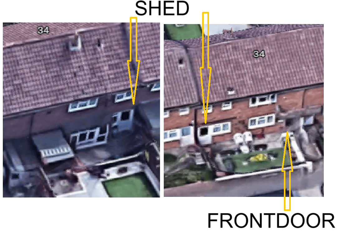

Putting this into perspective, in this instance the 'shed' is actually part of the house, a corridor running front to back of house, like this but a different property:

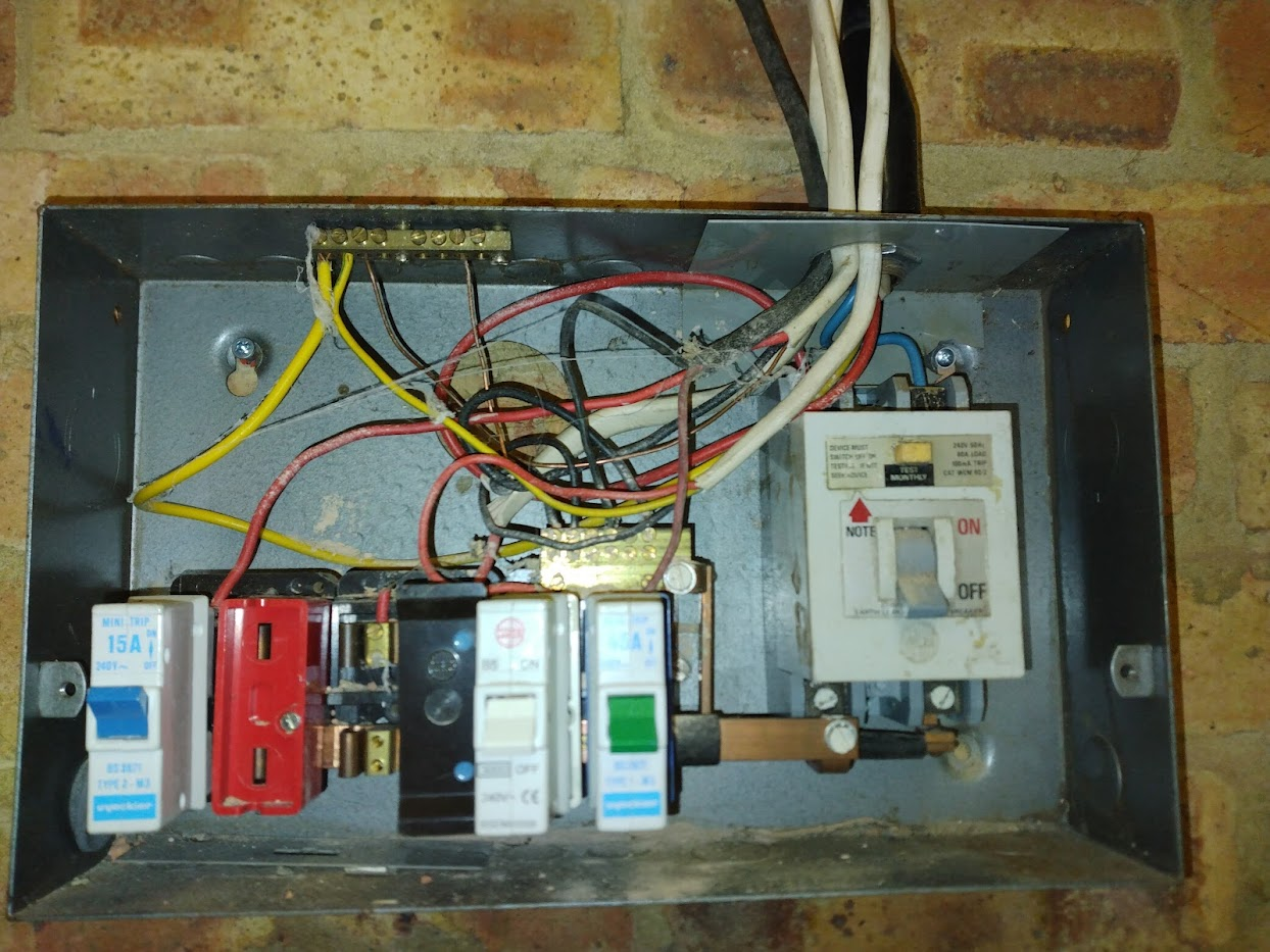

I did have enough blanks bases and 5 & 15A MCB and even a 6 way fuse cover. However this fusebox was a mess, this is after removing a handful of spiders web:
No internal covers

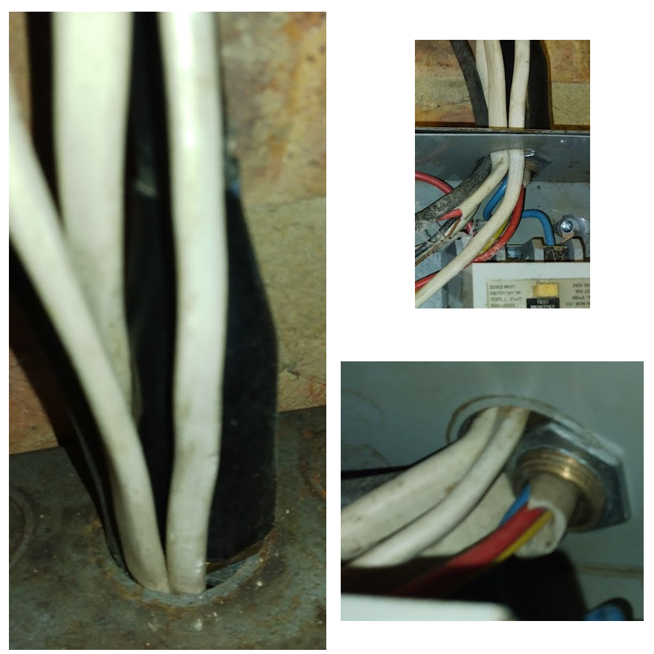

SWA gland and 4 cables in one hole with no protection, the lock ring wasn't anywhere near tightened:

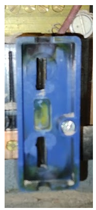

Twin rubber flex (I very much doubt its as big as 0.75mm²) on 45A MCB in blue base (position 6)
(slots broken out/elongated to accept it) feeding a fluo light fitting, The silly thing is in the fitting there are 2x 3C&E wired for 2 way and a disused T&E wrapped with tape and live from a lighting circuit from main CU, restoring that and removing hard/perished rubber flex was far too obvious.
In the garden are 2 13A single sockets (one with pond pump plugged in) and both are wired with 2.5mm² 3C SWA back to shed, pump SWA is wired into SFCU (13A fuse) and 1.0mm² back to 5A MCB (position 5), other socket has DP switch and 2.5mm² back to 15A MCB (circuit 1). SFCU and DP switch are side by side metal clad and linked with bush
In the shed is DSSO with 2.5mm² back to 15A fuse (position 4)
100mA RCD took over 1 second to trip
Landlord was there and reckons this was the main fuse box prior to rewire end of last century when external meter box was installed.
We decided repair/restoration wasn't the best way to sort this so have Removed 1.0mm² T&E for pump and linked to DP switch, removed fuse box (as JW suggested) and replaced with DSSO. Left powered down awaiting 25A RCBO for main CU.
