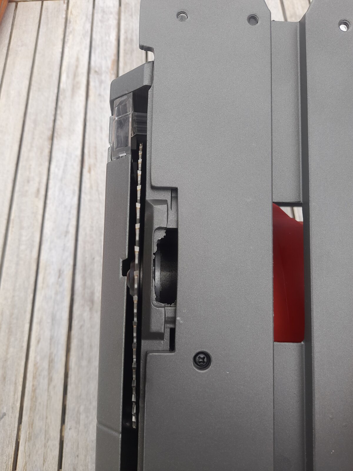

Hi All,
Just bought an einhell plunge saw and the tracks also. Before I take out the rubber strips for the first time I decided to check how the cutting disk lined up in the machine. If you look at the attached image the disc is closer to the machine body at the bottom of the picture than at the top. Is this correct, don't want to mess my tracks up if the disc isn't in the correct alignment.

What’s important is if it is parallel to track , the body of the saw may not look correct but it’s a cheap saw .
Flameport I've only bought it to cut my kitchen end panels, so I'm not going to spend loads of money on a plunge saw and rails. I'm only asking if anyone has any helpful advice on this and thought their may be some minor adjustment I can do.
Might be a trick of the light, but the blade doesn't look parallel to the body.
It's not opps, some other people online mention some toe in rather than a parallel blade to body.
@Sonic70 - which is the front of the saw in your picture? The blade should be set parallel to toe in. If it isn't and it isn't adjustable then take it back to swop. It should be parallel to the track not the saw base.
never tried toe in as parallel to me is 100% now not saying it wont work [i assume sub1mm] but it will mean the blade cutting on the upstroke on the back edge as well causing possible burning and extra drag on the motor
I agree big-all, I would set it up parallel. I will contact manufacturer on Monday to see if it can be adjusted to be parallel.
i suspect iff you go ontop at each end off the base just behind the guard you will have 1 or 2 bolt/screw/hex screw at each end off the guard
they will be before the groove underneath so in a 50 or so mm area

from !ink posted there is an exploded parts drawing. My observation is the Sole and the Power head Cradle are separate items so adjustment / alignment should be possible. I'd look to check the distance from leading and trailing ends of the blade to the closest edge to the blade of the furthest rail slot.
Diver Fred. Thanks for that, just what I was looking for yesterday but couldn't find. Much appreciated.
