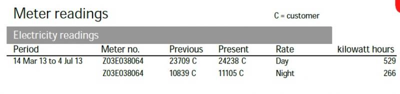

I wish to change my electricity metre in my property to a single tariff metre rather than the current Economy 10 metre. I have no storage heaters or any use for this type of metre and my bills are very high.
my energy company has said that in order for them to change the metre, I need to in the first instance get an electrician to check the wiring is suitable for a single tariff metre.
I have attached some pictures of the consumer units and the electrical metre etc.
btw, I have 2 consumer units installed, 1 is for the main house and 1 is for the loft dormer which was built in 1992.
Any help would be appreciated

They seem to be suggesting you get someone to check that nothing is still using the economy supply (eg heaters) so that when they disconnect the economy bit they don't leave you without heating etc. Assuming nothing else was ever connected to the economy side of things, you should be ok since you say nothing uses that tarrif any more. Does beg the question though, if nothing is connected, why is your bill so high or is that just how it works?

That's just how it usually works. Although the off-peak (night) electricity is very cheap, the 'peak time' (daytime) electricity is appreciably more expensive than with a single tarrif. One can do the sums, and it usually works out that one has to use about one-third of one's electricity at off-peak rate before the bill gets cheaper than it would be with a single tarrif.

I do use some of the off-peak tariff, but how do I know what is using it? I put my washing machine & Dishwasher on sometimes in the evening so I am assuming its that?

As I've just written, from the point of view of EON and your meter/tariff change, I doubt that anything (or anything significant) will need doing. As others have said (and as their letter more-or-less says) I think there only concern is for you to ensure that there are no parts of your installation which are wired such that they only work on 'off-peak' electricity (and hence might find themselves without electricity after the meter change) - but it doesn't sound or look as if that is the case. Even if the electrician did find some things which were wired in that way (which I doubt) it would probably only be a simple (and cheap) job to sort that out.

It looks as if your installation is wired such that any electricity you use during off-peak times will be charged at the off-peak, but that everything will also still work throughout the day (and be charged at 'peak' rate). It's only if you had some things (like storage heaters, maybe immersions etc.) which were wired so that they would only work at off-peak times that there would be changes required before the meter change.
