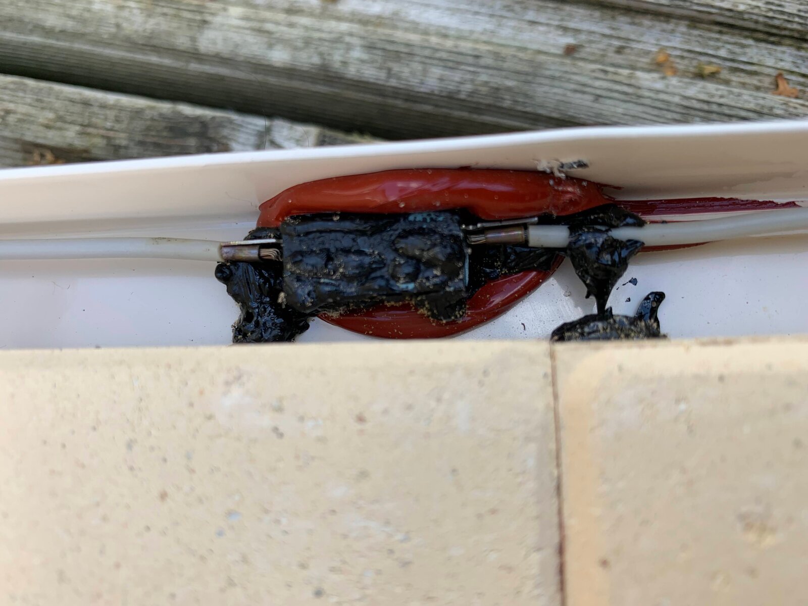

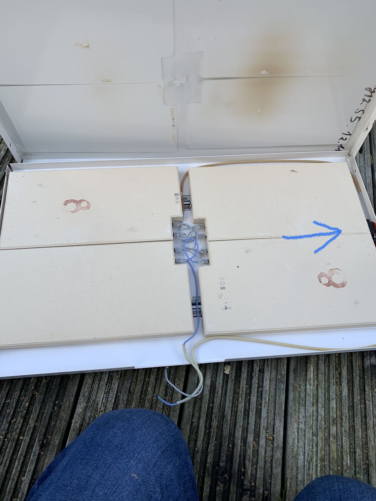

I recently moved into a house that has three wall mounted electric radiators. They are made my a German company called Elkatherm.
They are very simply and just have a temperature knob and a red light to show when the radiator is on.
Two of the radiators no longer heat up even though the thermostat clicks on and the red light comes on.
I opened up one of the radiators that wasn't working and discovered what looks to me like a burnt out electric component but I'm not sure. (see blue arrow in photo)
Can anyone tell me what this electrical is and does it look faulty? I thought I could perhaps replace it myself.
Many thanks,
Julian
Whatever that is has melted for some reason and certainly faulty. If it is at the top then its probably a thermostat of some sort.
But not a make that I'm familiar with. Maybe others do....?
EDIT: May be worth calling them. They're in the UK..
Make a note of the model number first!!
Looks to me like shocking design to put such a component in such a place.
I wonder if they all have the same fault.
Ordinary UK storage heaters have a thermal cutout or fusible link to break the power in the case of overheating, which typically happens when a user disregards the instructions and puts towels or something on top.
Many thanks for the replies and links. All really helpful. The models I have looks pretty old. I'll contact Elkatherm as advised.
Thanks again.
Julian
