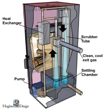

I was asked to write a web page saying how bad log burning is, however decided first to find out if really that bad.

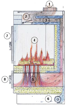

The major issue was particular emissions, there are a number of ways to avoid this, but the main one is to ensure the fire is hot enough, often with air directed above the fuel, to get the fire to burn hot.
However this means until wood is reduced to charcoal, it needs to burn at a set rate, however we want to heat the home to a variable degree, so we need a method to store the heat, then release as required.
Also all wood in fact also coal, has around the same heat release per unit weight when dry, coal is drier than wood so does have more output, but the fire is limited by volume not weight, so the grate needs to be adjustable to burn diffrent density fuel.
This means a very expensive system is required, if your going to burn wood in an efficient way, so in the main the wood burning fire is there as an emergency option should the electrial supply fail, it is not designed for daily use.

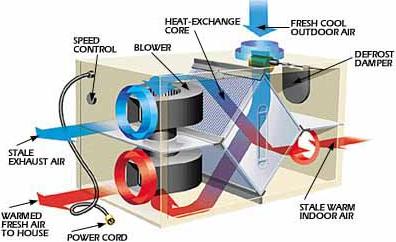

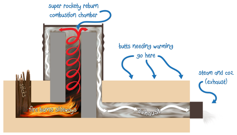

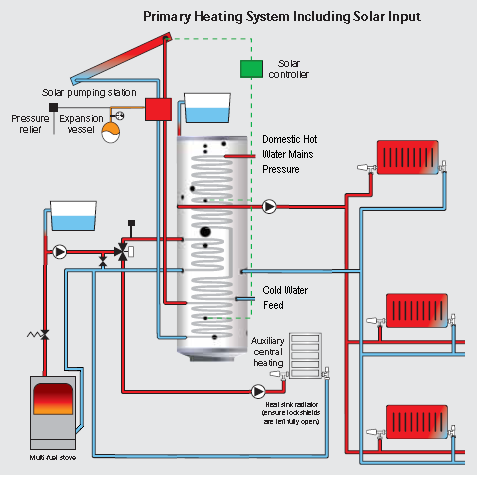

With an owner occupier I would have pointed out the methods used, the idea is normally to combine multi sources Torrent pipe example.PNG using a water heat exchanger, and have burners which draw air from outside burning it in an efficient manor, wallnoefer.PNGHughes Condensing Stove 2 small.jpgthere are some DIY methods rocket-mass-heater-diagram.pngthe latter two are condensing, but can't see how a tenant can install these, so seemed pointless to show them. The major fault as far as I see it is it needs some back up power, except for the DIY model known as the rocket mass heater, the super efficient wood burners need motors, so with a power failure you need either some method to put out the fire, or remove the fire, I remember as a lad when the water supply went off needing to drop the grate and carry the fire outside on a shovel. We had quarry tiled floors so they were not damaged with red hot coals being dropped on them.
The auto feed pellet burner can turn off faster, but it means getting wood Man_rummaging_thought_a_skip.jpg becomes expensive, the guy who asked me to do that web page, said most people with wood burners were thieves, think that is a little unfair, but he was finding people collecting wood carefully left to rot in his 20 acre wood land, messing up his attempt at natural forest practice, so I can see why he was unset at people taking the wood away.

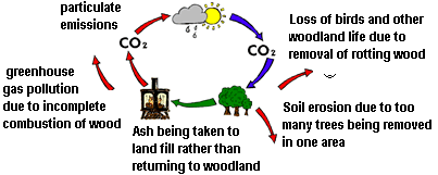

but the cycle as you can see is not complete, so burning wood is not good for the environment, however he still had BBQ's on his land, which must be even more wasteful. And he had at least three wood burners,

One plus for electric heaters is they can easy be switched on/off, using heat recovery units
and other methods to conserve the heat is a good idea, but one can select to use a small room in the winter and allow the home to cool down, there is no need to keep all rooms at 20ºC 24/7, one of the problems with central heating, is it is not easy to select what rooms are heated when, I have two zones, and the main house is sub divided into a further 8 areas each with it's own programmable TRV head, but they are not cheap, and a tenant would not want to fit his own programmable heads, so electric could work out cheaper due to the room by room control.
