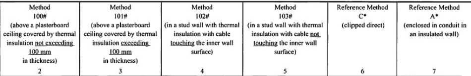

So 37 amps to 42.5 amps, using installation method 100 both would need 10 mm² rated at 45 amp. But that is for twin and earth, which is clearly not what you have, so it may be rated 60ºC, 70ºC or 90ºC, and we don't know how installed, we have a book full of methods some given here.
So how installed and type is important, so looking at table 4D5 we would have.
In theory, the cable is protected not the appliance, so if the protection device is not changed, then any overload would only trip the MCB/RCBO, but one can't be sure it was done correct to start with. I would normally test a cable size by trying crimps on the cable and see what size fits.
