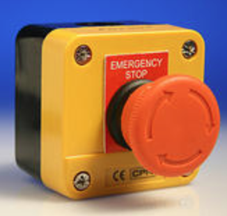

I think we have determined that according to the regs as long as you have an isolator somewhere upstream, that's enough for isolation. And for functional switching that's in the shower unit.
According to how worried you are, you can have more isolators/switches or even one of these:
but don't put it within 60cm horizontally of the edge of the shower tray whatever you do :LOL:

That is, indeed, true in terms of the regs. However, it leaves 'local emergency switching' (again, not required by the regs) unaddressed, unless the 'isolator' is local to the shower.

Since there are some here who are very concerned about the use of correct terminology, I would remind you that you are talking about "emergency switching", not "isolation".
